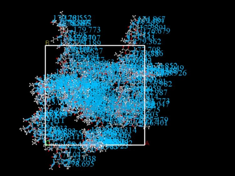

I want to create a box of cellulose acetate butyrate (CAB) in Material Studio. For this purpose, I create the cellulose structure, attach butyryl and acetate groups to this structure, optimize CAB with Forcite-Geometry optimization, and finally create a CAB box with Amorphous cell calculation. The final system is attached. I don't understand why this happens!
I would appreciate it if someone can help me.

Quite likely those measurements are already in the .xsd file(s) used for the Amorphous Cell run.
-double-left-mouse click into a measurement should select all measurements of the same type.
* right-mouse click into the .xsd file->Display Style->Measurements->Nome should allow to hide the measurements.
* Hitting delete should delete the measurements.

What happens?
Do I oversee the observed problem?

Well, I don't know. Numbers appeared in the structure.
Do I need to use DFT calculations in addition to optimizing and then create the structure?
