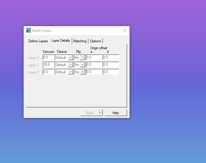

I'm attempting to obtain the binding energy of a Pt surface and water as a fucntion of distance. I followed the tutorial .Polymer interactions with a metal oxide surface) and built up the layer. (image 1 attached) The toturial is using a the layer builder to place a molecule on top of the Pr syrface layer and it doesnt say what is the distance between them.

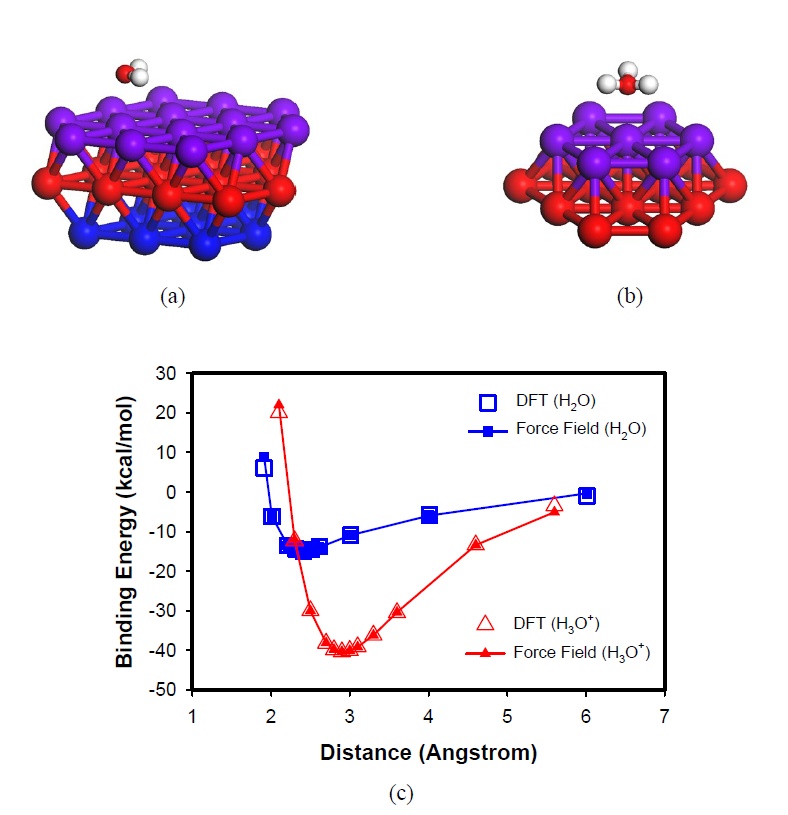

Im aiming to obtain the binding enregy versus distance as depicted in image 2 attached below.
Could you enlighten me on how to lower or raise the distance between the water and surface to obtain such a curve?
I assume this may be achived by increasing the LAyer 1, vacuum distance, uner Buil > Builld LAyres > LAyer Details tab?
Initially I set this value to 0, yet, as you notice in image 1 there's still a significant distance between water and surface, which is clearly not zero.
If you could please comment on this.

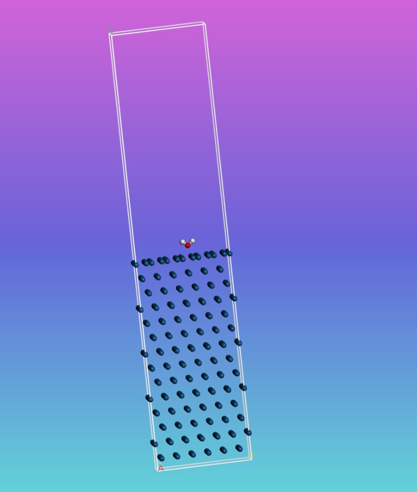

TK 2022-03-29
Hi.
How about manually moving the water molecules in the following flow?
1. Select a water molecule (turns yellow)
2. Adjust the moving distance from the "Movement" dialog.
3. Click "Muve Up" to separate the water molecule from the metal surface.

CM 2022-03-29
Quantitatively, this can be done by measuring the distance between a best fit plane and the O center of the water molecule.
This distance measurement (distance monitor) can be edited via the Properties Explorer. For the distance measurement it is important to select the Best Fit Plane first and then the O center because otherwise the atoms of the Best Fit Plane will be moved when the distance is changed.
