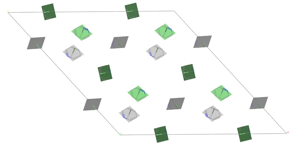

I have a system that includes several 6-rings. Following MD simulations, I aimed to conduct post-processing analyses, one of which requires obtaining the normal vectors of each 6-ring plane versus time.
So, I made BestFitPlane out of all 6-rings (please see the attached figure) and then wrote the following code:

However, upon running the code, I got this error:
"There is more than one object in the "BestFitPlane"s collection (function/property "BestFitPlane") at -e line 13."
Would you be able to kindly advise me on what I have missed in the code? Thank you, SJ

When I changed BestFitPlane to BestFitPlanes, I received this error: There is no function or property named "UnitNormalVector" on type "Object" at -e line 21.
After selecting one of the bestfitplane, in the properties explorer, one can see in he BestFitPlane row: something like  r.(aa,bb,cc)=cc. I suppose aa,bb, and cc should be the bestfitplane vector elements. How can we reformulate the code to get these values? Many Thanks, SJ

I just changes the the code as follows:
#!perl
use strict;
use Getopt::Long;
use MaterialsScript qw(:all);
my $doc = $Documents{"new0.xtd"};
my $std = Documents->New("NormaleVectors.std");
   $std->ColumnHeading(0) = "Nx";
   $std->ColumnHeading(1) = "Ny";
   $std->ColumnHeading(2) = "Nz";
my $bestFitPlane = $doc->UnitCell->BestFitPlanes;
my $planes = $bestFitPlane->BestFitPlanes;
for (my $frame=1; $frame<=$doc->Trajectory->NumFrames; ++$frame){
       $doc->Trajectory->CurrentFrame = $frame;
       my $BFPCounter = 0;
       my $i=0;
       foreach my $plane (@{$doc->UnitCell->BestFitPlanes}){{++$BFPCounter}
        $std->Cell($i,0+($frame-1)*3) = $plane->BestFitPlane->UnitNormalVector->X;
        $std->Cell($i,1+($frame-1)*3) = $plane->BestFitPlane->UnitNormalVector->Y;
        $std->Cell($i,2+($frame-1)*3) = $plane->BestFitPlane->UnitNormalVector->Z;
        $i++;}
And it worked.
Please feel free to advise me if you see any issue in the code
Thanks, SJ
