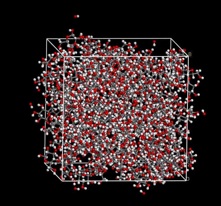

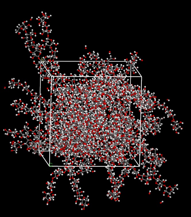

I have question regarding the construction of the Amorphous cell. First I have read that when we construct the Amorphous cell, Amorphous cell construction task allows us to  build a three dimensional periodic structure containing a specified number of molecules, of one or more compound. So when i am building the amrophous cell my molecules are comming out of the periodic structure. So i am not getting if Amorphous cell construct the periodic structure,  how the molecules are getting out of box? If I am doing something wrong, then please let me know how i can construct the amorphous cell with all the molecules in the periodic box. For your refernce i am puuting the images of my amorphous cell below.

Hi
The crystal repeats infinitely but only one unit cells worth is shown by default. If you wish to show more than one unit cell, right click in the window and select Display style | lattice tab and change the Display range. Alternatively if you wish to see atoms "in cell", change the Display style (on the same dialog) to "In-Cell". Remember  that this is a visualization option only and it does not matter to any MS module if the atoms are displayed in cell or not.
See thread, 10032, 22015 and many more for similar issues.
