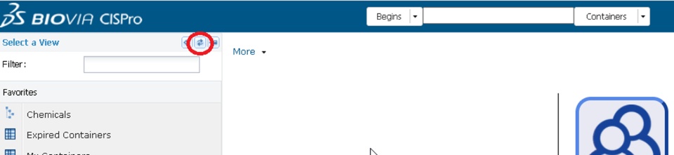

In the top right hand corner of the View Selector there are three small buttons.  The middle button (shown below) is refresh.  If this action does not correctly refresh the View Selector then log out of CISPro and clear the browser cache.
