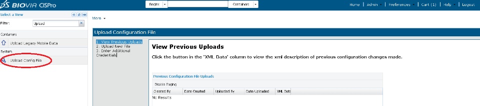

CISPro: How to update the CISPro license file?
If the number of CISPro user seats/licensing or licensed modules is changing you will need to upload the new license file. In a stand alone instance of CISPro (not synched with BIOVIA Foundation) you will need to log into CISPro as a member of a group with the Action Permission to "Upload Config File"'. If your CISPro instance is synched with BIOVIA Foundatio we recommend to log into BIOVIA CISPro as the Scitegicadmin account user and after logging in with the appropriate administrative account open the "Upload Config File" action from the view menu to step through the XML upload process
