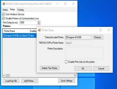

Remove from Print Client
  • Open the BIOVIA CISPro Label Printing Client and go to the Setup Tab
  • Double Click the printer to be removed.
  • When the Printer Setup details open, select “Delete This Printer” > OK > Save Settings
