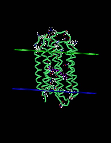

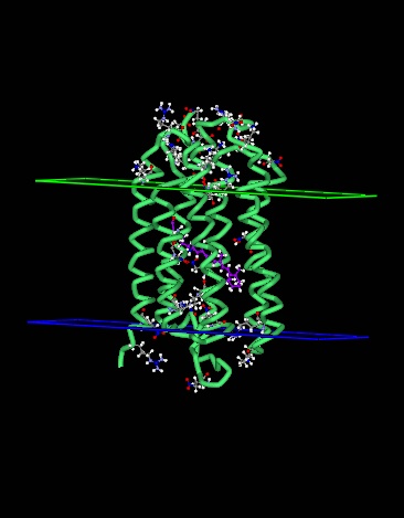

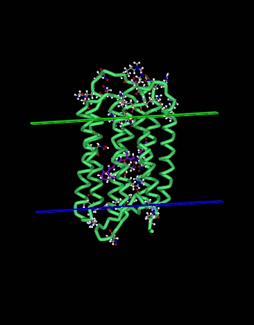

First the scripts. The new SaveImage function for several document types allows you to save out several image formats, I use PNG. By default the image is saved using the size of the current window, but you can specify a different size as optional arguments. By rotating the image or animating a trajectory in between calls to SaveImage, you can produce a set of numbered images. Attached are three scripts to do this. The first two rotate such as to spin the molecule 360 degrees, or rock it side to side by 15 degrees. The third script loops over all conformations in a trajectory and saves each as an image. Each script saves a numbered series of PNG files into the folder containing the script.

This will create an animated GIF file. GIF is a reasonable format for short movies like these. Although it does not support full color, most animations from DS look good. I've attached the three GIF files produced using the scripts above.
Click image or "Save Link As" to view animations.
