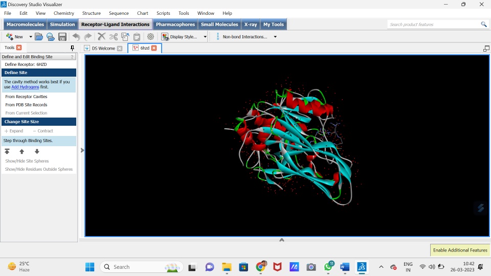

In my system discovery studio there is issue , all the options of receptor ligand interaction such as display receptor-ligand interactions, display receptor surfaces , change the visibility of the receptor and ligand , show receptor ligand interactions on a 2d diagram are not showing . Please help me how to resolve this issue.

Hi Adil. From the screenshot I can see that you are using the Discovery Studio Visualizer which has limited functionality compared to the full Discovery Studio Client. The visualizer is opened when it cannot check out a license for the full client. This might be because the machine cannot connect to the license server or because all client licenses are currently in use. To check open the License Administrator under Start>All Programs>BIOVIA and see if you are connected to the license server. If the connection is made but you cannot check out a license please run the diagnostic report to see if there are warnings or errors.
