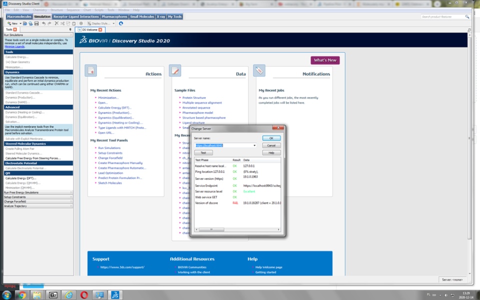

I have installed DS2020 with new license but when i try to connect localhost it fails.
The error is:
- Version of dscore - FAIL
What should I do?
The error is:
What should I do?
Looks like you are trying to connect to a Pipeline Pilot server that is running version 2019. Did you install a 2020 version of the Pipeline Pilot (DS) server? If so, you might have used different port numbers. Try specifying that port number instead of 9943 (assuming you installed a 2020 server).
Thank you for your answer. I did not install 2020 version of the Pipeline Pilot. Where can I find this version to download? I have tried to find it but I can not do it.
You should be able to see it on the Download Platform once you have logged in. It should be in the same folder where you downloaded the DS Client. For Windows the file is called BIOVIA_2020.DiscoveryStudio2020_Win64.7z and for Linux it is called BIOVIA_2020.DiscoveryStudio2020_Linux64.tgz. Note, to have a complete server installation you will also need to install the GPL package (i.e. BIOVIA_2020.BIOVIABiologyGPL2020_Win64.zip or BIOVIA_2020.BIOVIABiologyGPL2020_Linux64.tgz). The steps to follow to install the server are detailed in the Installation Guide which is part of the Documentation.zip file also found in these folders.
