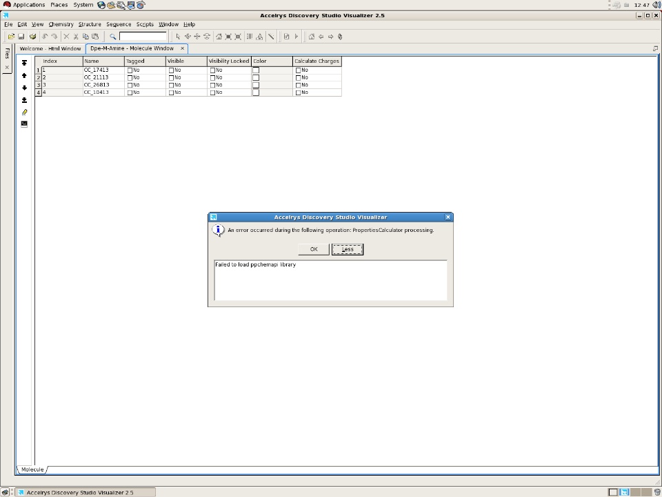

I have just recently installed DS Visualizer 2.5 on my linux machine.
I was using the old DS Visualizer 2.0 previous to that.
The problem is when I try to open sdf, mol2 files etc in the 2.5 version i get an error message, please see attachment of a screen shot.
It fails to load ppchemapi library.
Can anyone please help?

This is probably due to a missing prerequisite, most likely libXpm which was not documented as being required on RH5 for 2.5 but really is.
Please try installing the libXpm package and try again.
Yes I'm using RedHat 5.
Which disk is the libXpm package in?
