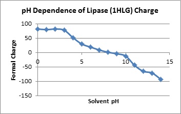

Hi there, I'm trying to use DS 3.0 to determine a moleclue's pH vs. charge relationship. I'm taking a PDB file (for example, 1HLG), loading it into DS, then running "Prepare Protein" with different pH's. According to Brockerhoff and Jensen, 1974, the isoelectric point for 1HLG (human gastric lipase A) is 4.9. But this is the plot that I generated from the data I collected:
The charge was determined by using the sum of the formal charges, which I obtained with this script:

I was able to replicate this issue with other molecules, as well as with single amino acids. At the expected isoelectric point, the charge was always around 10-20, when it should have been 0. Does anyone know what I'm doing wrong here?
