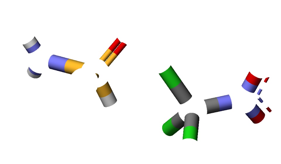

I've recently downloaded & installed Discovery Studio 3.0 Visualizer to create some molecular graphics.  However, with every molecule I create the balls in the ball & stick model will not display.  I've tried every display setting I can find, but nothing seems to fix the problem.  Below is an example of the blank spots I see.  Am I missing something obvious?  Any help would be really appreciated.  Thanks!

Hi Leah,
Did you use a graphics card which is supported?
Try dis enabeling the hardware acceleration under Graphics preferences, this might fix the issue.
Hope that helps
Jurgen
HP
HP 2011-04-12
Hi Jurgen -
My graphics card was supported & disabiling the hardware acceleration didn't help.  However, since you suggested it might be a graphics card issue I updated my drivers and now it's working!  Yeah!  Thanks for the help!
~Leah
HP
HP 2011-05-28
[Belated post for others that have the same issue]
I was able to resolve this problem by unchecking the "OpenGL Shaders" box in the "Graphics" section of the "Molecule Window" category under "Preferences".
