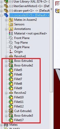

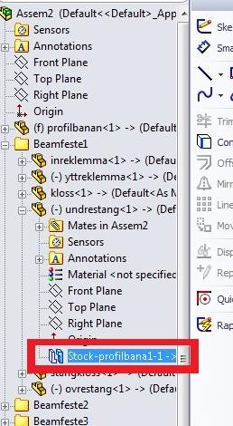

Have a question here.
Is there some alternative to split parts? Because I want to be able to edit the part inside the assembly, (picture 2) which I can´t if the inserted part is made as a split part, picture 1.
Sure, I can edit the part in the main-model where the split is made but now for example I´m in a position where I want the splitted part extruded up to a specific surface in the assembly, which I now can´t do.
Would be great with some help. Cheers!
/Joseph

You can insert the master part in the assembly and suppress it, then unsuppress it only when you want to edit it.
Dwight
SM
SM 2011-03-12
Josef,
You can also insert your part into your assembly and create
2 seperate solid bodies within the part in assembly mode.

Create the multibody part and make it the master. Then you convert that into assembly: Assembly from Part – No mates required
OR make a master sketch in the assembly itself and model your parts in assembly mode (top down or in-context approach)
