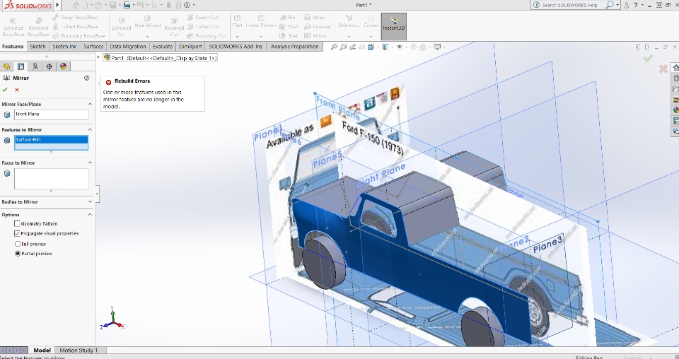

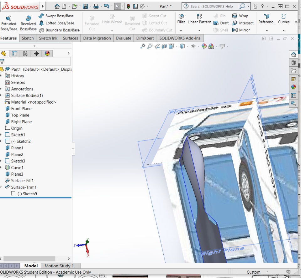

Why surface has a bend outward and won't mirror
The side of the truck surface feature has a large bend inward/outward I would like to get rid of. How do I fix this issue the sketch is rather flat and doesn't contain guide curves that create dent should be flat or slightly curved at tip. Also, Solidworks won't mirror the side of the truck surface stating the surface is no longer in the model to create the mirror on the other side of the Front Plane.

Instead of selecting the surface for "Faces to Mirror", will it work with "Bodies to Mirror" instead? I've found that to be much more robust

Hello  ,.. I'd suggest not doing a composite curve and fill but do a simple extrusion of the side panel and trim/knit  (image/file)

The error states the feature(surface-fill) is no longer in the model and clearly visible.  I would like to mirror the surface to go to more advanced surface modeling and mirror them.  The behavior of the surface is awkward, I attempted pattern and thicken and they both provided error prompts.

Like I stated earlier, if you select the surface within the "Bodies to Mirror" dialog box instead of the "Features to Mirror" one, the result usually works when the feature mirror fails.
