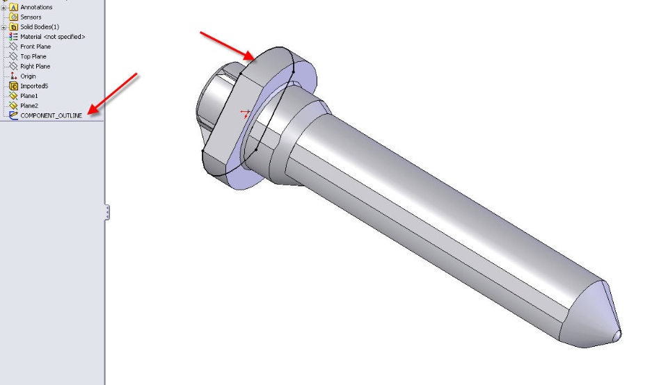

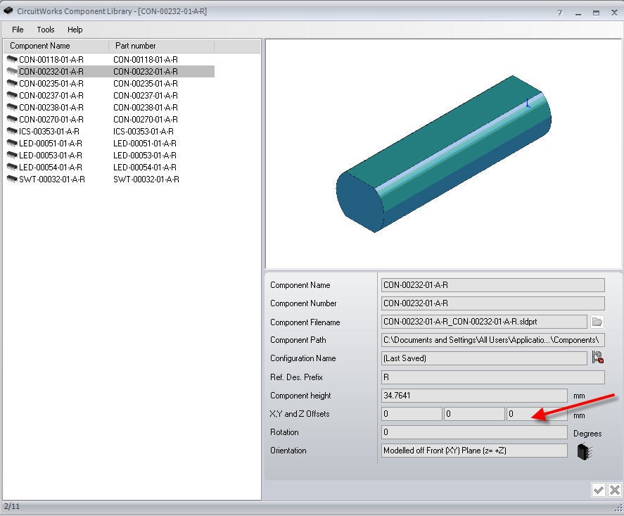

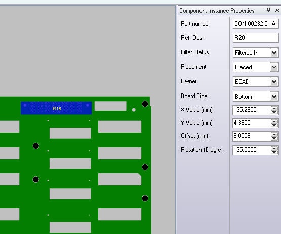

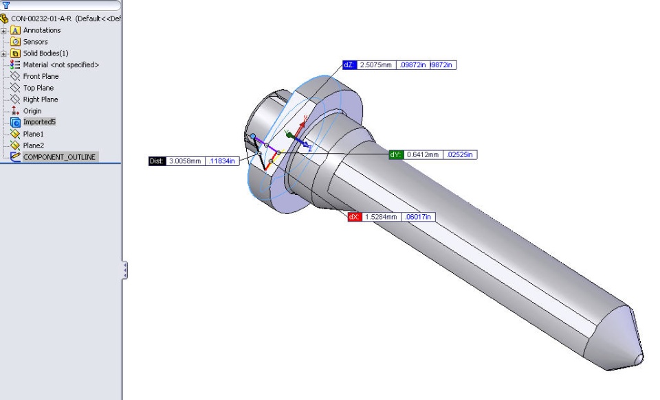

We are seeing the same issue. I attached some screen shots of one of the parts.
We have just upgraded to SW 2010 and immediatley saw the problem where our bottom side components are inserting an offset to those parts automatically. This causes the parts to appear floating off the bottom side of the board when exported back into solidworks.
How is the offset setting determined? Does pins cause this offset to be added in automatically? We have not seen this before 2010.
If anyone has seen this issue (or a solution to it), let me know! Thanks!
