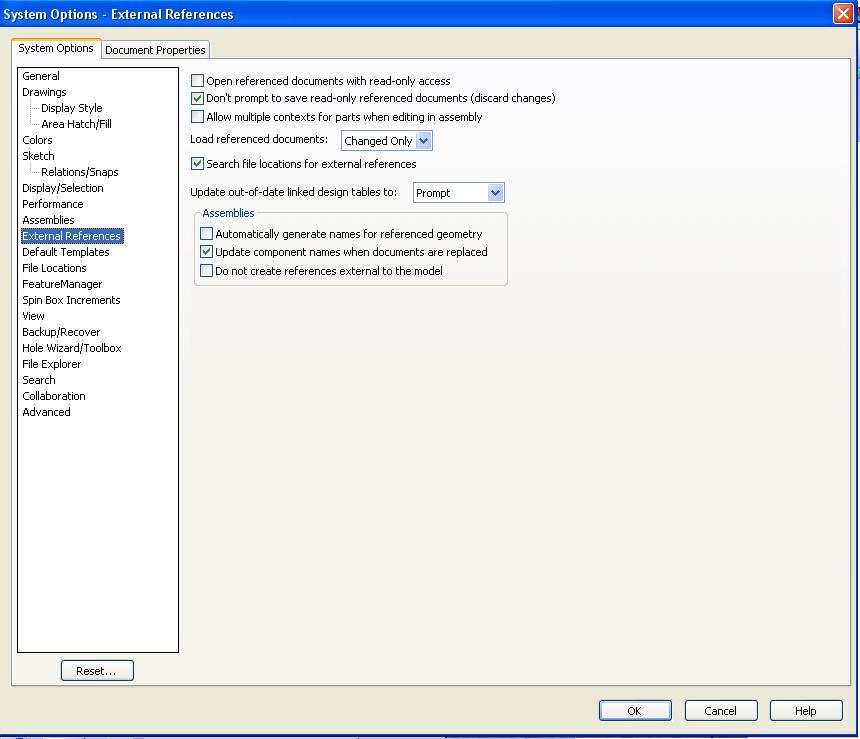

DG 2011-10-03
Make sure you don't have the option "No external reference" on in the assembly.
Check on the assembly tool bar or Under Tools > Options > System Options > External References

JS 2011-10-03
Good afternoon Deepak,
Attached is what I found.  According to what I see I don't want it checked is that right.
Do you understand what I am trying to do?? Did you try it??

JS
JS 2011-10-03
Frank assisted me on my issues, yes you can select the points of a skeleton part.
Process is, for those who don't know;
Create Skeleton Part
Insert into a New Assembly and Save Assembly
Insert New Part and add Base Sheet Metal in new part
Add Edge Flange, select sketch point from Skeleton Part
Ctrl & Select new edge flange sketch and make coincident
Thanks Frank
