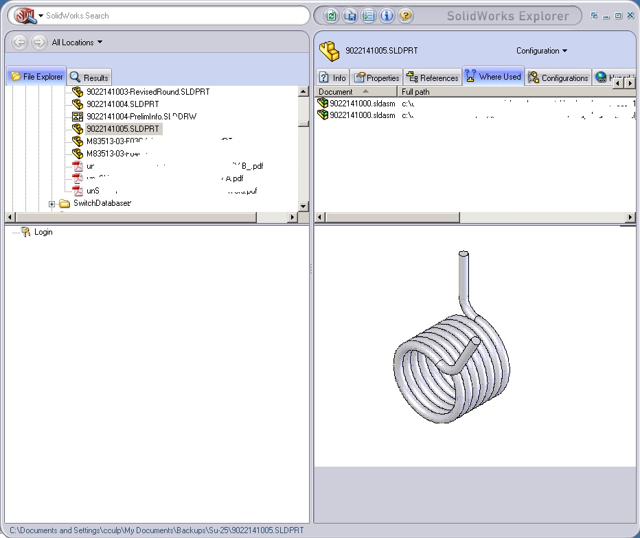

CC 2007-11-20
Yes.  It is part of Solidworks Explorer.
You have to have Solidworks Search enabled (I believe),andindexed.  If you have never used it, it is prettystraightforward...
See attached screenshot (with some information whited out...)

First, you don't have to have PDMWorks installed in order forSolidworks Explorer to run. If Solidworks explorer is crashing whenyou attempt to a where used, then the problem lies elsewhere. Startby making sure Solidworks explorer is patched to SP1.0. You can dothat from the customer portal.
Second, the where-used functionality in Solidworks Explorer doesn'tuse the indexing service. It uses a straight-forward windows searchmechanism. You specify locations to search for files in theSolidworks Explorer Options dialog box. You can also specify thatSWEX search subfolders of those locations automatically. This makesexplorer take a long time.
That brings me to item three, using the rename/replace menufunction to run a where-used. If you haven't specified a searchlocation-as indicated in my second point-Soldiworks explorer willsearch for affected files in the active folder only (the folderwhere you ran the rename or replace)
Finally, I have to disent in part from Matt's statement that thiscan't effectively be done without a PDM system. In my experience itall depends on the quality of your referential structure.Solidworks explorer can pick up references (both assembly andin-context) in Solidworks documents and xrefs in AutoCAD documents.So, if your model is a 100% reflection of your BOM, then awhere-used search will yeild pretty good results. PDM/PLM/EDMsystems allow you to create manual relationships between documents.For example, in Cyco Meridian, you can associate an inspectionprocedure with an assembly so that when you change a component aspart of an ECO, you'll know that you also have to update thetechical illustrations.
My company uses an ERP system to run 'Where used' reports. It alsodoes the item master and the individual boms for our parts, so allof our CAD and documentation is kind of window-dressing for thatdatabase.
Anyway, try patching your Solidworks Explorer installation, I thinkthat will give you results similar to what you get in Inventor(without the VAult ofcourse)

On the crashing you are having doing a Where Used in SW Explorer:
Make sure that the is no reference to PDMWorks in the SW Exploreroptions. CLick on the Add-Ins tab and clear the PDMWorks box. Also,there is a tab for References/Where Used, make sure you have one ormore paths listed there and that there is no refernce to a vault inthat path.
Hope this helps!
