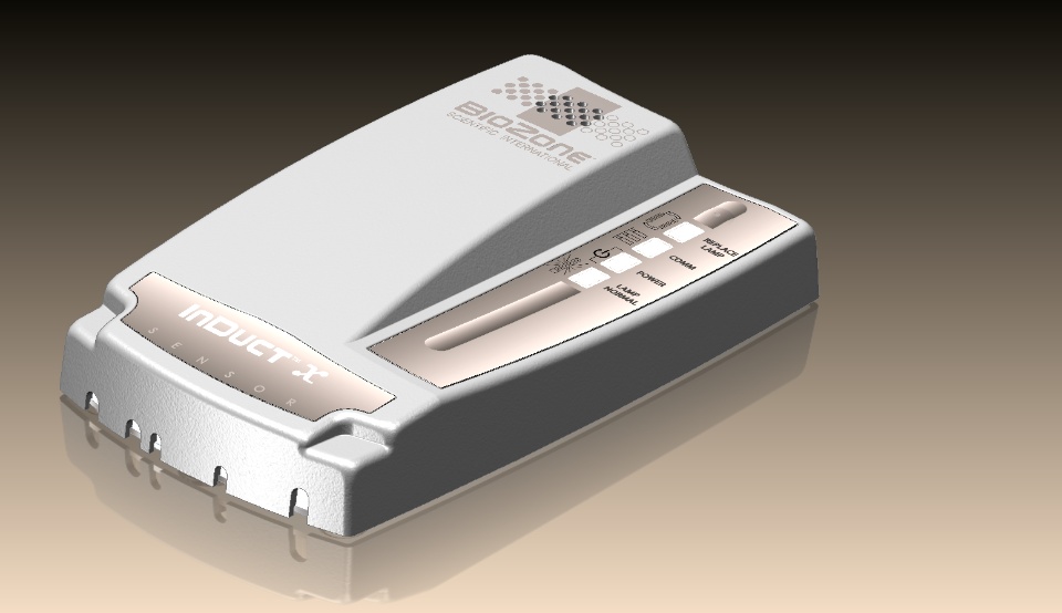

Here's the assembly without ambient occlusion turned on (draft or high-quality doesn't matter).  The envelope component is the enclosure itself.

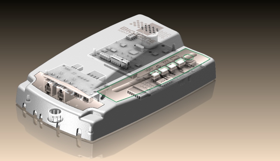

and here's it is with ambient occlusion turned on.
