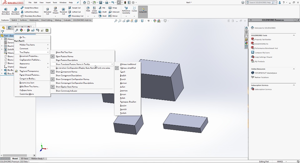

what do you say to the new option at the Feature Manager "Show Translated Feature Name in Tooltip"?
In my opinion it is a little bit confusing, because Tooltips already exists since ages...
The revised Tooltips start to be even cooler than the old ones, at least for beginners ...

The new "Show translated Feature Name in Tooltip" functionality will be useful when users who use different languages to create their files exchange files.
I second what Jim said. This feature was requested by many customers in different GEOs. We implemented it as a tooltip because translating feature names directly in the tree would be a risky approach and also rebuilding time would be long. More feedbacks are welcome.

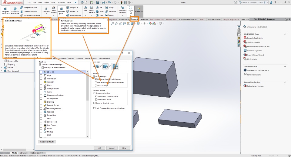

Jim is correct - the options in the Customize dialog relate to what I like to refer to as 'command tooltips' in toolbars and CommandManager. Other tooltips, such as those in the FeatureManager, PropertyManagers, and so on, either have their own visibility controls (for example, 'Dynamic Help' in some PropertyManagers) or always appear no matter what Customize settings you use.
What do you find confusing? The "Show Translated Feature Name in Tooltip" has nothing to do with the other tooltips throughout the system (as you've shown in your second image) but only for the tooltips in the FeatureManager tree (that is why it is accessible from the Tree Display context menu at the top of the tree). They are separate functionalities.
The new "Show translated Feature Name in Tooltip" functionality will be useful when users who use different languages to create their files exchange files. For instance, if I send you a file that used English feature names, you can set the tree display to show the German name in a tooltip as shown in the image below:
Or if you send me a file that you created with the German language, since I do not know how to read German, I can have mine set to English and it will show the English name in the tooltip. So, in practice, I would always have mine set to English. Then if any user from any other region sends me a file in another language (German, Japanese, Chinese, etc.) I will always have the English translation in a tooltip. This is very useful since I don't read any of those languages.
Translation of the feature names has been a very long standing request of SOLIDWORKS users. I understand why SOLIDWORKS likely implemented it as a tooltip rather than translating the tree directly; then it is just a display feature and does not modify the original data. If they were to translate the names and replace them in the tree directly, what should happen? Should it become permanent or temporary? If the translation was just temporary for display purposes, it would be very confusing; for instance what should happen on rename or should rename be blocked in such situation? If the translation was to become permanent rather than just a display function, this would have to mark the file as modified and require it to be saved to keep the changes which causes problems with revisioning and PDM systems. So, I think the tooltip implementation of translated feature names is a pretty good solution.
