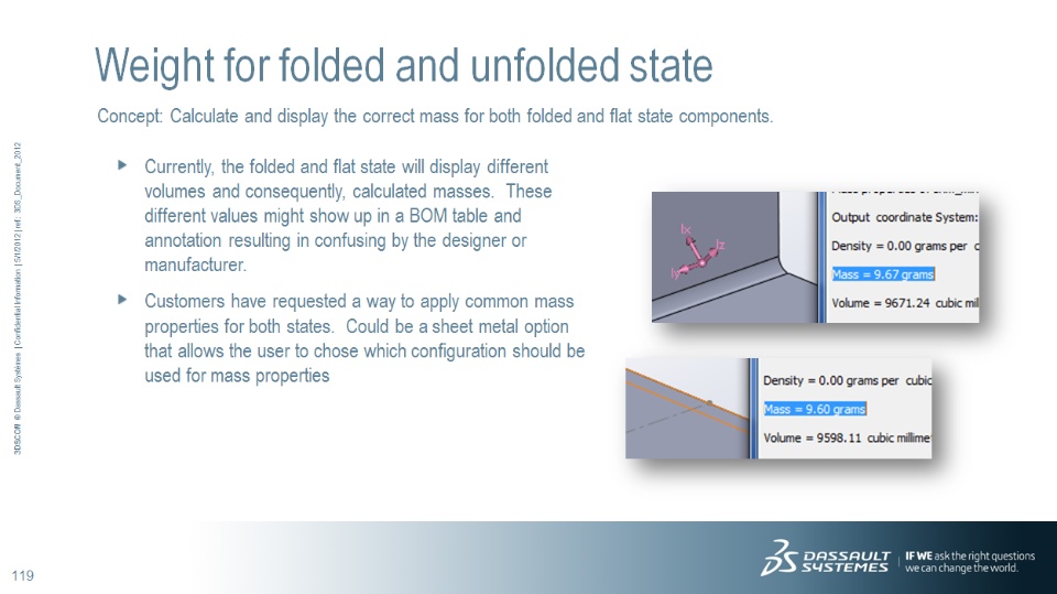

I am not sure the usability of this issue. The discrepancy between the folded/unfolded state is because in the flat pattern is where the bend allowances types are applied. This mean the flat pattern volume/mass will be slightly less

I think this is related to the flatten anything project. We need ability to more accurately flatten material to get better results in calcs.

I don't think we have a problem with weight in flat pattern. The problem is creating the correct flat pattern (particularly in lofted and swept bends).
However a few ideas here
1) Ability to display in the graphics with perhaps some percentage numbers, the superimposed flat pattern with and without bend allowances. This basically will show the shrinkage of the part after applying bend allowances
2) We need to correct the discrepancy in the flat pattern that sometimes is created when a part is unfolded and folded back. At times the flat pattern is not the same in this type of situations.That is the flat pattern before the unfold is different from the one after the fold back.
