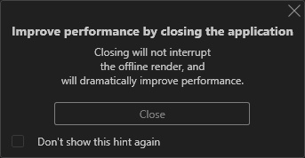

Traditionally, when you start a rendering from within the Visualize application, there is a second, headless instance of Visualize (called OfflineRenderer.exe) that takes care of rendering the scene. What are the advantages and disadvantages of using a second executable to render your scene?  For starters, it lays the exact foundation required for doing true offline renders, ie using Queue.  In fact you can consider this traditional mode of rendering (which we now call Background render mode) akin to sending your job to the Queue and having it run/executed immediately.  Behind the scenes, a copy of your project is saved, and then loaded into OfflineRenderer.exe, and rendered with the settings specified.  The other main advantage of this work-flow, is that while the scene is being rendered, you can still use Visualize.  You can switch back to the main tab and begin making more modifications to your scene or even load up a new project. Your render will continue to process. Or you can shut down Visualize altogether and your scene will still be rendered, since it's happening in another process. In fact you may recognize this small pop up dialog, when the rendering starts.
As indicated, "Closing will not interrupt the offline render". The dialog goes on to say that doing so will "dramatically improve performance".
