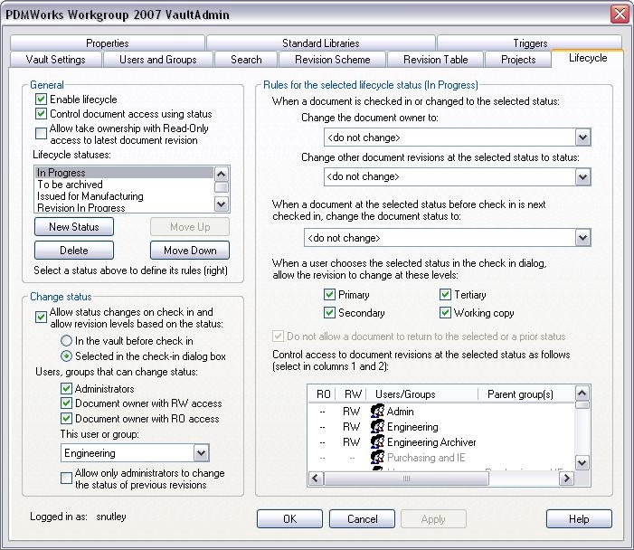

Can anyone give me a screenshot of their 'Lifecycle' page oftheirVaultAdmin program and briefly explain how a user checks in anewdrawing. I'll attach my page and tell you what I'm hoping todo.

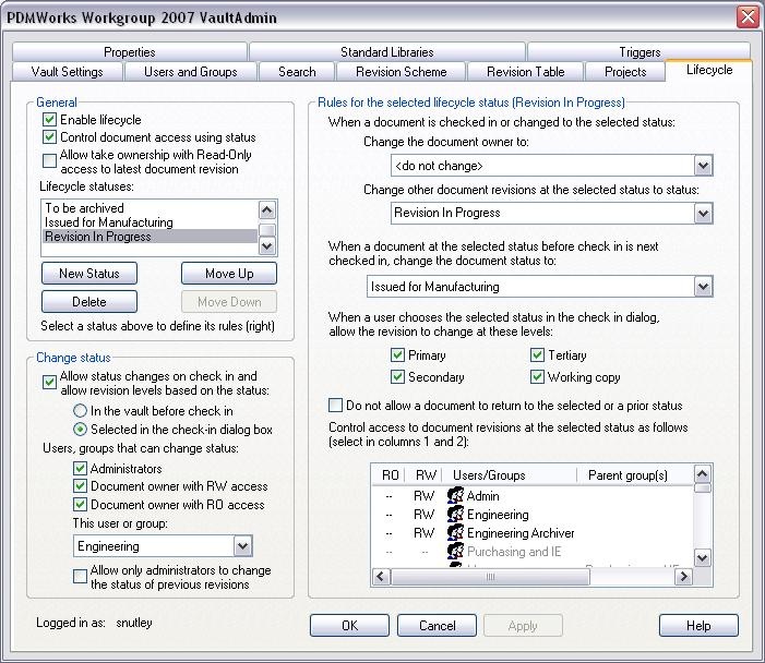

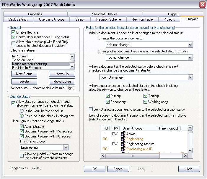

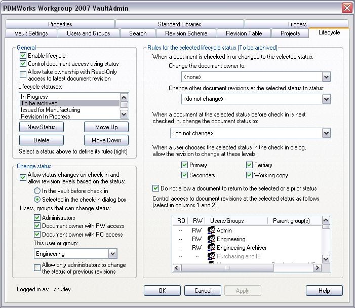

A user checks in a completed drawing at the 'To BeArchived'lifecycle and into the SW_Arch project. Users in otherdepartmentscannot access this lifecycle. An administrator makessure thefilename is correct, moves it to the correct project andchangesthe lifecycle to 'Issued for Manufacturing'. Otherdepartments can now access this file. When an engineerneeds torevise a drawing, he checks it out and changes it to the'Revisionin Progress' lifecycle which other departments have noaccess to.After the revision is done, he checks it in and anadministratorchanges the lifecycle back to Issued forManufacturing.SolidworksWorkgroup Pdm
