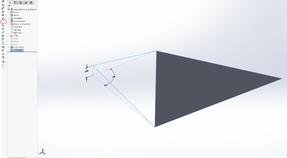

Hello,
I am trying to make a simple, triangular, planar surface from the current sketch (Already done with the previous sketch). I know it's a closed sketch but the planar surface tool refuses to recognize the sketch as a feasible definition for it (aka the tool is unselectable/grayed out). Why is this happening? I attached the part file.

 .. you are correct!.. exit 3DSketch, Planar Surface, RMB, "Start Contour Select"

It works fine for me.. (SW18sp5) Exit the 3DSketch, select Planer Surface and use the Contour Select tool..

In my view Surface-Plane is used for 2D sketches. Filled-Surface is used for 3D sketches.

..can't argue with you,.. it is planar and imho the planar surface feature should be available but.. it would need a "Enhancement Request".... yeah, that lame we have to request something so friggn obvious..
(exit 3DSketch, Planar Surface, RMB, "Start Contour Selection")

When you use 3D Sketch you have to use Surface-Fill.
