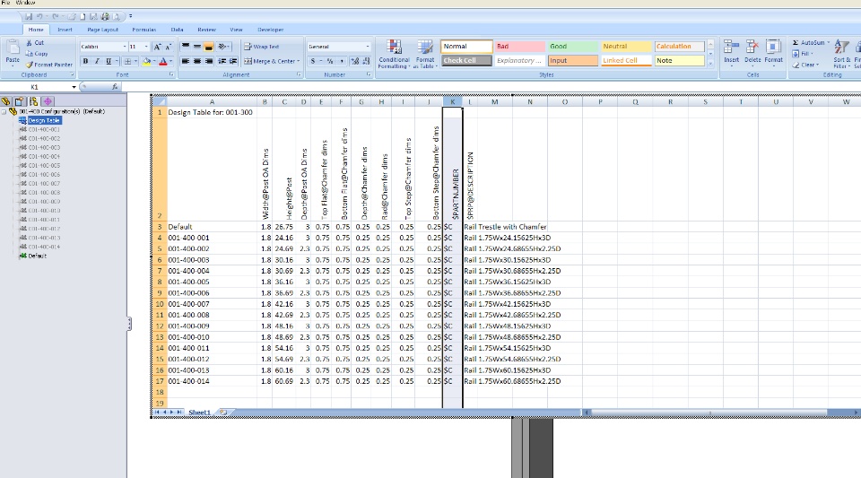

I looked through the api help to find how the Part Number concept is implemented in Solid Works. I am not used to using files that have a name equal to part number. I want to use a custom property (Part No) that represents the part number of the file, while the file name is something more human readable (something like description).
So, in the end it comes to how do I tell the BOM to use the PartNo custom property to display the values in the Part Number column.
