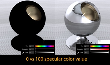

0 is pure black and 100 is white, with grayscale in between.
Think of value as the percentage of the effect that the HSV-color is applied to. For example:
If you’re tweaking the color of your appearance’s “transparency” and set its value to 0 means you’ll have zero transparency. Setting it to 78 will give you 78% transparency and so on.

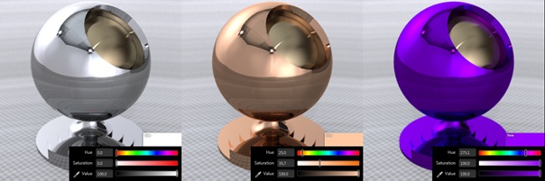

This principle applies to all parameters with a HSV-controller. Setting your value to 100 in your specular color will give you an appearance that is fully reflective. You can set your hue and saturation to whatever you like if you want to give your reflection a color tint, but those values will have no impact on the actual amount of reflectivity.
These three examples have all of their parameters except for specular color zeroed out (black).
They all have unique values for their hue and saturation - however all of their values are set to 100. And as you can see although they reflect different colors, they all share the same amount of reflectivity.

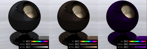

These use the same colors as above but with a value of 40. The reflection amount is consistent.
