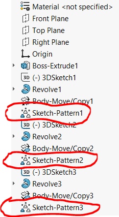

Hello,
I am running a macros code (please find attached) in which I am creating few sketch patterns and bodies. After the macros runs, I need to be able to "play" with the created bodies: delete some of them, combine some of them, and re-pattern on the sketch (which are just dots at selected XYZ coordinates). Ideally it would be part of the macros script. However, for now I would just like to know why I am not able to select or use the sketch-patterns from the design tree and how I can solve it.
Please find attached the TXT files to run this code.
I would also like do credit @Ivana Kolin for the help with this script.
(The script is a bit long but uses 3 functions that are the same except for calling different TXT files)

Private Sub AddSpheres(X As Double, Y As Double, Z As Double)
Dim swFeat As SldWorks.Feature
Dim swFeatMgr As SldWorks.FeatureManager
Dim skSegment As SldWorks.SketchSegment
Dim bStatus As Boolean
Dim D As Double
If Not swSketchMgr.ActiveSketch Is Nothing Then
swSketchMgr.InsertSketch True
End If
Open pathName & "Particle_1_Size.txt" For Input As #4
Input #4, D
Set swFeatMgr = swModelDoc.FeatureManager
'Select "Front" plane
bStatus = swModelDoc.Extension.SelectByID2("Front Plane", "PLANE", 0, 0, 0, False, 0, Nothing, 0)
'Insert new sketch
'Create arc
Set skSegment = swSketchMgr.CreateArc(0, 0, 0, 0, D, 0, 0, -D, 0, -1)
'Add vertical line
Set skSegment = swSketchMgr.CreateLine(0, D, 0, 0, -D, 0)
'Add arc center point to current selection
bStatus = swModelDoc.Extension.SelectByID2("", "SKETCHPOINT", 0, 0, 0, True, 0, Nothing, 0)
'Add "Midpoint" relation between arc center point and vertical center line
swModelDoc.SketchAddConstraints "sgATMIDDLE"
'Clear selections
swModelDoc.ClearSelection2 True
'Select vertical line
bStatus = swModelDoc.Extension.SelectByID2("Line1", "SKETCHSEGMENT", 0, 0, 0, True, 0, Nothing, 0)
'Add dimension
'Set swDispDim = swModelDoc.AddDimension2(-D, 0, 0)
'Exit sketch
'Add Revolve feature
bStatus = swModelDoc.Extension.SelectByID2("Sketch2", "SKETCH", 0, 0, 0, False, 0, Nothing, 0)
bStatus = swModelDoc.Extension.SelectByID2("Line1@Sketch2", "SKETCHSEGMENT", 0, 0, 0, True, 4, Nothing, 0)
Set swFeat = swModelDoc.FeatureManager.FeatureRevolve2(True, True, False, False, False, False, 0, 0, 6.28318530718, 0, False, False, 0.01, 0.01, 0, 0, 0, False, True, True)
'Clear selections
'Get the body
bStatus = swModelDoc.Extension.SelectByID2("Revolve1", "SOLIDBODY", 0, 0, 0, True, 1, Nothing, 0)
'Move the body to the first point
Set swFeat = swFeatMgr.InsertMoveCopyBody2(X, Y, Z, 0, 0, 0, 0, 0, 0, 0, False, 1)
'Clear selections
'Get the body and 3D sketch
bStatus = swModelDoc.Extension.SelectByID2("Body-Move/Copy1", "SOLIDBODY", 0, 0, 0, True, 256, Nothing, 0)
bStatus = swModelDoc.Extension.SelectByID2("3DSketch1", "SKETCH", 0, 0, 0, True, 64, Nothing, 0)
'Pattern the body
Set swFeat = swFeatMgr.FeatureSketchDrivenPattern(True, False)
Close #4
End Sub

'Clear selections
bStatus = swModelDoc.Extension.SelectByID2("Body-Move/Copy3", "SOLIDBODY", 0, 0, 0, True, 256, Nothing, 0)
bStatus = swModelDoc.Extension.SelectByID2("3DSketch3", "SKETCH", 0, 0, 0, True, 64, Nothing, 0)
'Pattern the body
Close #4
End Sub
