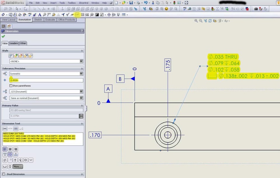

I have a part which has multiple counterbores. When I go to dimension this feature in a drawing I am only able to add tolerances and annotations to the last line of the dimension. (Image Attached)
In Solidworks 2010 this was never an issue, I would simple add whatever extra text and tolerance I needed and it would display correctly.
Has anyone else encountered this and if so, is there a work around besides using a note?

Manuel,
I would specify what you need to in the sketch of the counterbores
then import them using insert model items.

Scott,
This would be a horrible way of doing this. My Counterbore is a design library feature  which I created to save time since multiple counterbores (holes with more than 1 Counterbore) are not possible with the hole wizard. If I did insert model items I would end up with a leader for each hole (4 seperate dims) instead of just one neat one.
If they are possible with the hole wizard please let me know how as I have been unable to create anything but a simple counterbore or countersink with the hole wizard.

Manuel,
Can you post an image of the cross section of the counterbored hole?

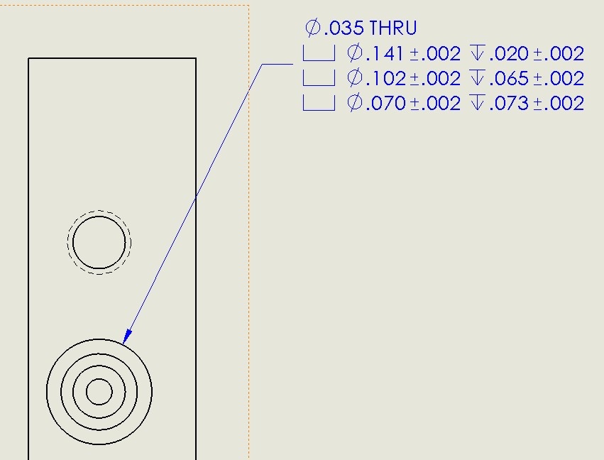

SF 2011-06-30
Scott,
No problem, here you go.

SF
SF 2011-06-30
Well, I have some more info to add. After opening a drawing which was created in SW2010 with a simular feature I am able to edit the dimension text and add tolerances.
This only seems to happen when adding a new dimension.
SF
SF 2011-06-30
Scott,
I made the hole per your suggestion using the hole wizard. However, when you dimension the hole in a drawing the callout only shows the original hole dimensions and not the extra counterbores that were added. Good news is that I am then able to edit the dimension and add tolerances to all the other lines. (see attached image). This is also time consuming as you have to add all the text for the last 2 lines.

SF
SF 2011-07-06
Well,
Solidworks has officailly identified the problem as a bug (614226).  Hopefully it will get fixed before the next service pack comes out.
