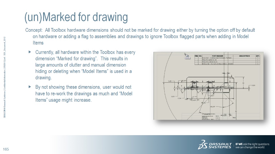

We should have a macro writer (one of the developers) create code that can run through the 2014 database and turn all of these Mark For Dim's off via brute force. If we have a swtich that looks or doesn't look for them, we run the risk of preventing a user from legitimately using them on a case by case basis.
JS
JS2012-05-04
I'm confused on your reply here. Your first sentence looks like you want to unMark them all but your second makes it sound like we can't because some users might want to use them.
Perhaps the same dialogue as the 90° bend thread?
ML
ML2012-05-04
Yeah, my other reply suggests that these are essentially the same topic (or at least may have the same solution). I'm not sure about doing it in the Import Model Items tool, though.
JS
JS2012-05-04
Why not the Model Items tool? This is how they get shown

We are looking for more feedback on this idea. Please post your thoughts.
