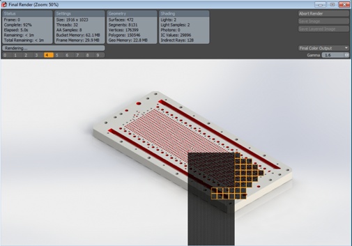

The CPU is the fastest you can buy today for rendering. it is a 2-processor system, running the brand new Xeon E5-2687W, running 3.1GHz with 8 cores, two processors, with hyperthreading. This will show a total of 32 hyperthreaded cores. Wow. They are also very expensive at \\\$1,900 each. There is a cost/benefit payoff for speed, so purchase the CPU that meets your price/value point:

Here's what your PV360 view will look like:
