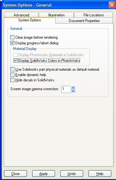

>Then you cannot make a part fade in and out during ananimation, using >photoworks? Is this true?
Partly...
It should work if you set your system option like this (seeattached)
SF
SF 2007-01-25
Hi Mike:
I tried the method you provided, but still can not get the fadein/out effect, is it possible to show some sample for us? Thanks inadvance.
