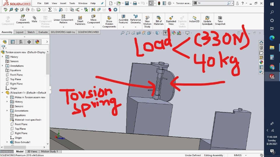

Guys. I need a torsional spring (single helical or double helical to withstand a force of 40kg ( 392 Newtons ). Can I get this spring with this much load capacity. Pin dia in the following image is 10mm and the length for the spring is about 50mm.
I can adjust these dimensions, based on the availability of the required spring.

https://www.centuryspring.com/catalog/torsion-springs Use their calculator to see if they have a stock item that works...If they don't call them up and ask them if they can make something close.
