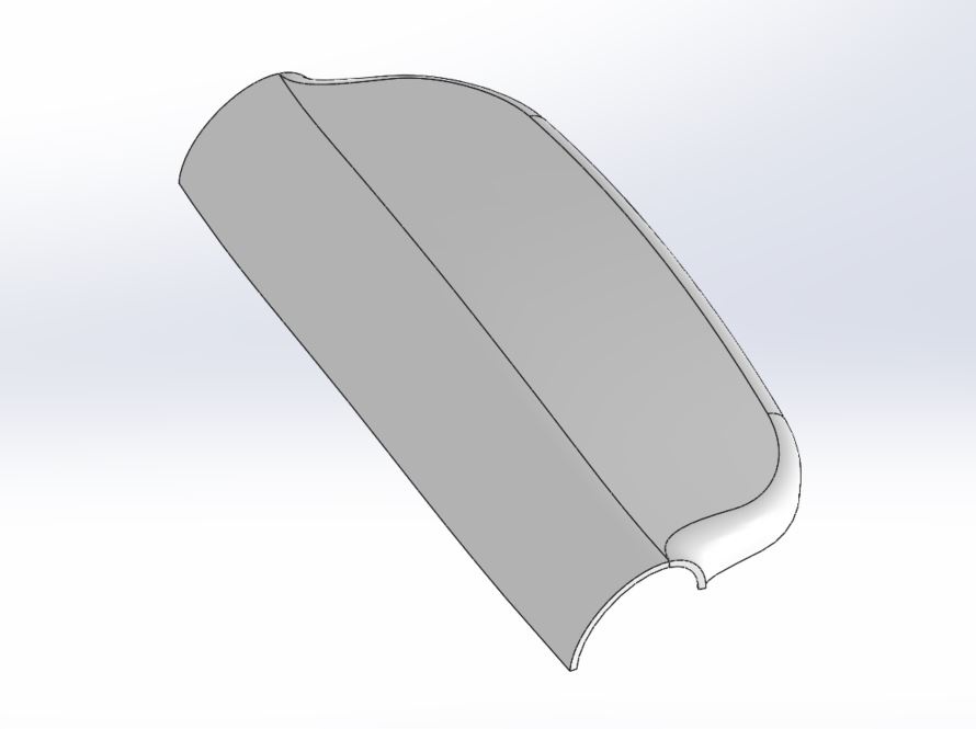

I am trying to give a draft for a surface which I can't.
This is cover with surface body. I made shall to make this solid.

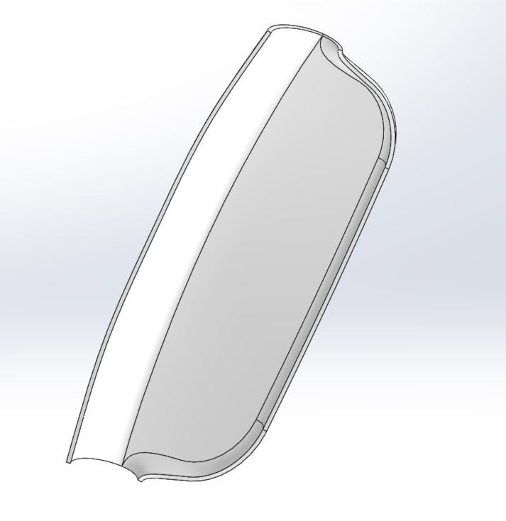

And this is lower side of cover.

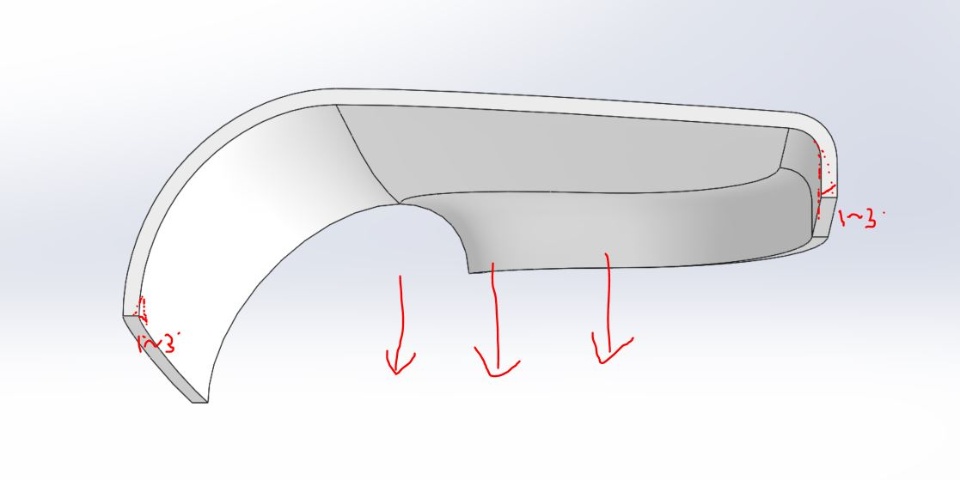

I have to make a draft as upper image.
How can I do this?

You can't. Draft work for planar faces. You must change geometry
PS
PS 2020-04-22
..you may be able to get away with this?   that is, of you kick it about 1.5 degs the undercut could help with holding the core on.. so, depending on the texture (or not).. talk with your mold maker and see if it can be made as is?
