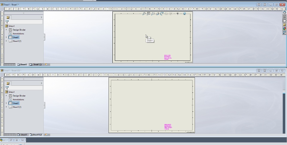

Well, did you know that when you are in a drawing, you can select Window--> New Window to open a 2nd instance of that drawing?
Then, you can go to the other sheet in the 2nd instance and work from there.
Same drawing, different sheets shown:
Test it out.

Dan Pihlaja wrote:
You can do this with any Solidworks document.
Want to see the far side of a part while you are working on this side?  Window--> New Window and rotate the other window how you need it.
Want to see another area of an assembly while you are working in this area?  Window-->New Window and now you have a whole new viewpoint to see from.
I have tested out the assembly portion of it and when I hide something from one window it immediately hides from the 2nd window.....no lag or anything.
Or you can just use viewports:
Granted, you don't get multiple FMDT this way.

Thanks man.  Just been trying it out.  Seems it's one of those there-but-not-quite features, I'm seeing some behavioural oddities with it.  e.g. second instance wasn't changing what was displayed on the sheet until a Ctrl-Q, or dragging a view from one sheet to another caused the dragged-from sheet to suddenly switch to showing the dragged-to sheet (meaning both sides were showing the same).
This kinda highlights an issue with the SPR system as well - SPR 716611 is still showing as open / not implemented when to all intents and purposes it is...
