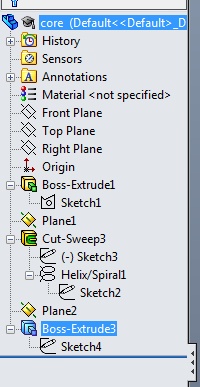

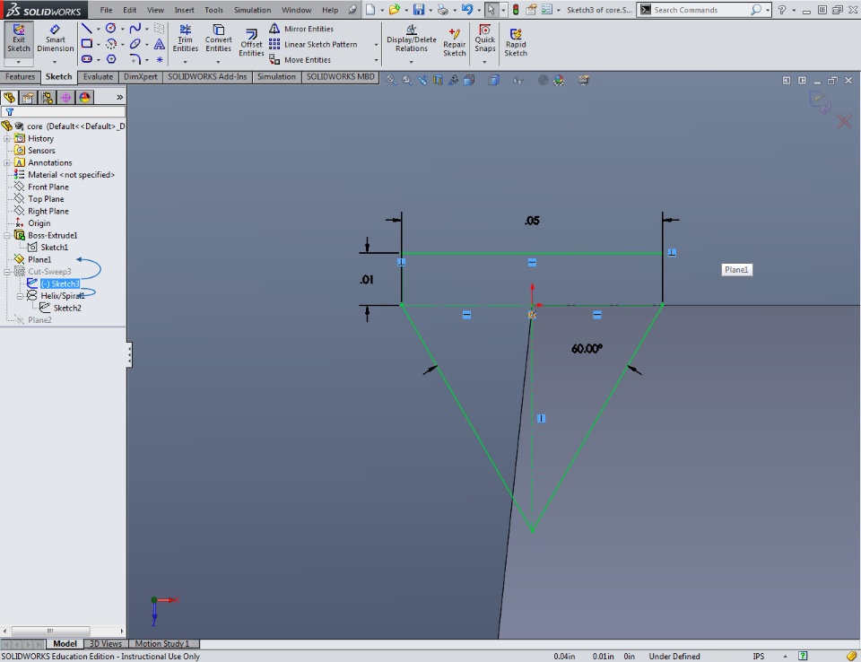

I extruded a 36 x Ø 0.75 rod and threaded the whole thing with a profile swept cut
then i made a plane in the middle to extrude a Ø 0.75 cylinder along part of the rod to make it not have threads there.

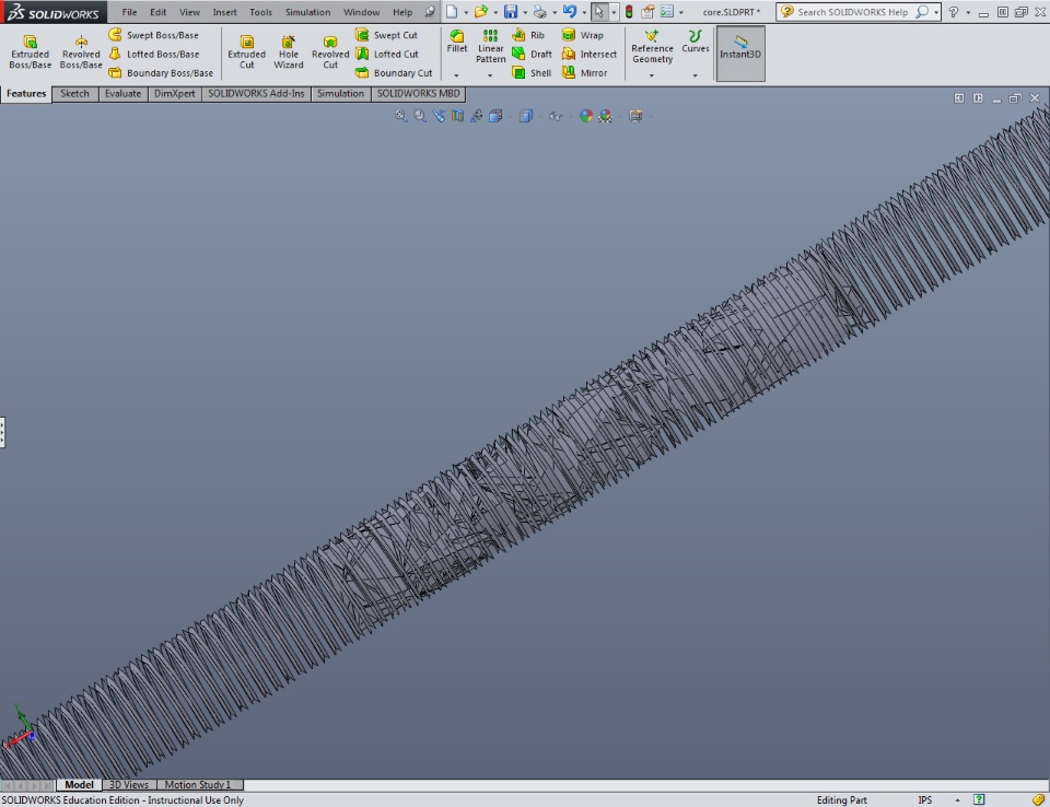

The result is a crumpled piece of paper inside of a fancy spring..
so I suppose this is a tutorial for a crumpled paper in a spring
It looks like something that would happen in 3ds max when you test random modifiers you have no idea about

Interesting. I hope you know how to quickly fix this by cutting the part first and then creating the cylinder.
MP
MP 2015-07-21
You're approach is reasonable. But I've seen exactly this multiple times, so it doesn't work. SW just can't figure out where the borders of that body are. The way to a healthy partially threaded body is to extrude the cylinder, then sweep cut the threads as-required.

That is probably caused by the non-approved graphics cards you are using. Neither the Nvidia GT650M nor the Radeon HD series are suitable for solid modelling with SolidWorks.
AW
AW 2015-07-21
I agree with Kelvin...  More then likely a non-approved graphics card issue.
Post you part so we can open it and take a look.
