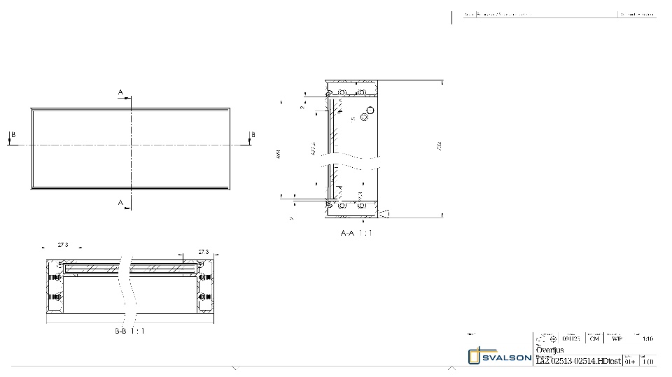

We are in the process of reducing paper drawings at our company and I have some thoughts about creating a new drawing format for computer screens with 16:9 aspect ratios.  Almost all of the designers, and even our workshop are using 27 inch 16:9 screens.  The problem is that showing an A2 drawing on such a screen wastes some of the screen space and beckons for the shop worker to "print me out" so that it is easier to see.  On the other hand, if there is ever a need to have a paper version, the paper version will have wasted space.
I've calculated dimensions for two formats, one to fill a 27" screen, and one to fill a 40" screen (which no one at our business has--yet).  These sizes seem to be standard for new monitor.  And by the way, it seems like all new large monitors are 16:9 aspect ratio.  That is part of the problem I suppose.
HD 27 format: 336 mm high, 598 mm wide
HD 40 format: 498 mm high, 886 mm wide
I've attached a drawing with the HD 27 format for anyone with a 16:9 screen to look at. Quite nice when I look at all the extra space freed up on the right.

How about giving them (shop floor people) e-drawing, so that they can zoom in/out, pan, etc. in the drawings and you can use the standard sheet sizes. Just my 2 cents.
SF
SF 2010-03-23
I tried that at your suggestion.  I think it would be workable, but even an e-drawing on an HD monitor has wasted space if it is an A format.  Either you have to zoom in to fill the screen (and then you don't see the entire drawing) or you don't fill the screen.  Is there some advantage to having using the e-drawing reader for drawings as opposed to a PDF reader?  I noticed some disadvantages; it didn't look like a paper drawing (dimensions were gray) and I didn't see an option to completely fill the screen with the drawing.

The format looks great on my 30" Dell monitor.
I think it is a great idea.
