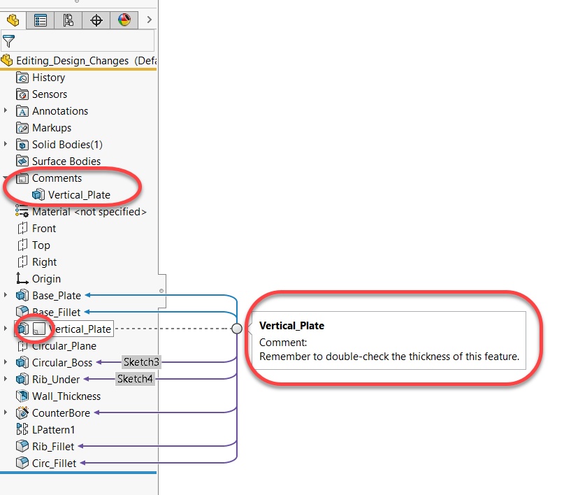

I love comments in the FeatureManager Tree. They are fantastic for many reasons:
  1. A quick way to include your thoughts directly in the model.
  2. Can include pictures
  3. Can take screenshots

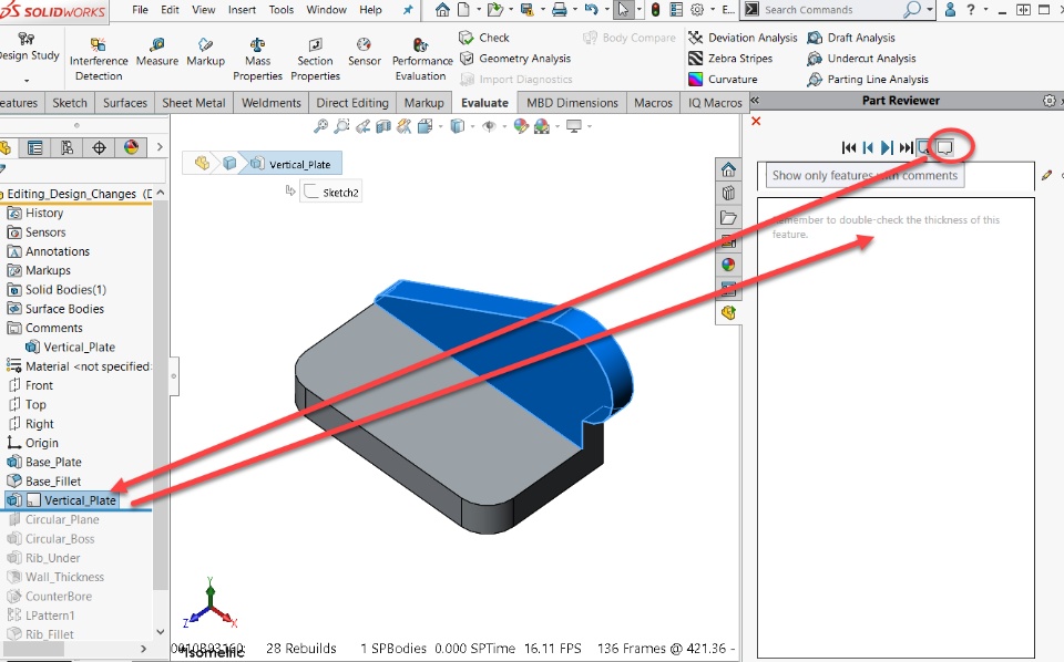

  4. Can be used as "bookmarks" in history of the part using the Part Reviewer! This way, a user who is not familiar with your model can roll the FeatureManager tree automatically from bookmark to bookmark. So instead of wasting time going through 100 features, he or she can stop only at the 5 that you deemed critical.
  5. Feature with comments get an entry in the Comments Folder
  6. Feature with comments get a special icon in the FeatureManager Tree
Bottom line: comments can be very useful. If I were a manager of a team of SW users, I would brainstorm with the team the best way to use them and then make using them mandatory!
The missing 5%:
1. The Comments folder is almost useless:
When I click on one or more features listed there I want to get full functionality:
  • get the context toolbar
  • get the standard RMB menu
  • select the feature(s) in the graphics area and the FeatureManager tree.

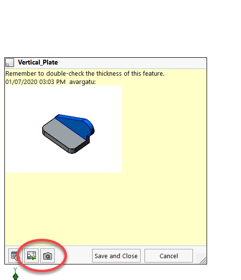

2. There is no indication that a screenshot or image has been added to the comment. If an image is available, it should be included in the pop-up caption.
What else would you use Comments for?

I use comments very frequently. I've always wished if I could:
  1. Be able to change comment's font size/color/style. On my 24" monitor, comments' font is very small and very hard to be read.
  2. As Shawn Stugard has mentioned, be able to open one of the comments when a part/assembly opens.
  3. Being able to rotate/zoom the assembly. When comments windows is opened and I'm typing, Solidworks' main window is freezed. I can't rotate/zoom the assembly nor select any components. So if I want to add a screen shot from a different angle, I have to save and exit comments, rotate the assembly, edit the previously saved comment, delete the additional auto added date stamp and then take a screen shot.
  4. Being able to take a screen shot while a component is selected. I'm trying to add a comment to a sub assembly with a screen shot when a component is selected, but Solidworks de-selects all components as soon as I open a comment window. I have to take a screen shot with a 3rd party application and import it to comments.
  5. Better quality for imported images.
  6. Stop auto resizing the image. Or if you auto resize, don't change the ratio of the image.
The following image shows a comment window with an imported jpg file to show above No 5 &  6 points. You can notice the terrible change in the quality and size ratio of my image and what Solidworks has imported.
