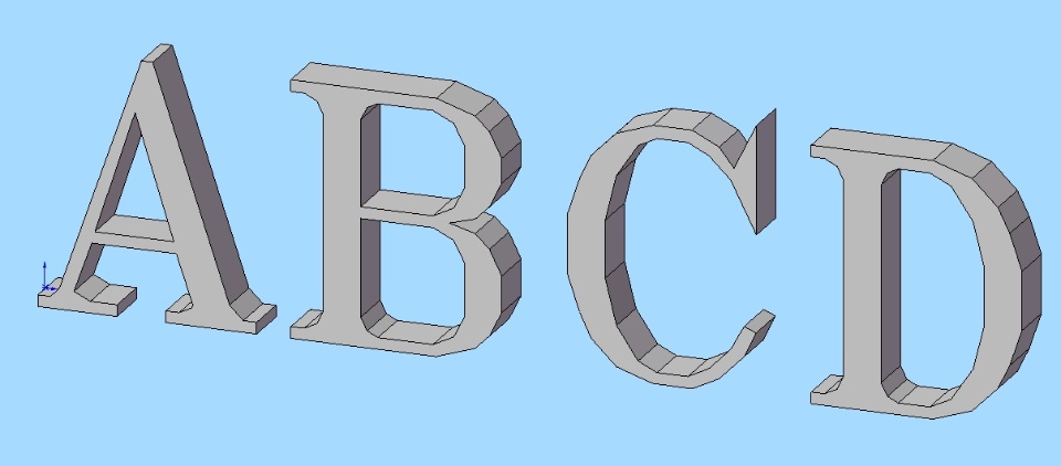

When I make text on a sheetmetal part everything works fine.I disolve the text after I've got what I want. I put in theappropriate 'bridges' and I'm done.
The problem is, when I import the dxf file into SigmaNest to make acut file, all the arcs in the text become short lines. When thelaser gets to those lines, it hesitates and 'jumps around'. When itcomes to a true arc, it cuts fine.
Is there a way, besides putting in new arcs in the text, to fixthis??SolidworksSheet Metal

Travis,
I'm guessing that SigmaNest does not use splines, and the splinesare being converted into short line segments. I have triedexporting from SolidWorks using the "export all splines aspolylines" option which generates arcs; however, my results arepoor. It may be that I am missing some "quality" or tolerancesetting to break the splines into smaller arc sections for betteraccuracy.
I know there are a couple free spline to pline converter scriptsfor AutoCAD. (Unfortunately they do not work with the DWGEditor.)There are also a few stand alone converters to generate arcs fromsplines in a DXF/DWG that are reasonably priced.
I'm hoping there is a good method to do this quickly in SolidWorks.If there is not a tolerance setting, using the "split" tool mayachieve the same results at the expense of time.
UPDATE: I increased the image quality and performance settingsbut did not get any improvement in the dxf quality.
I did use the "split" tool on the splines that were causingproblems and was able to increase the number arcs for betterquality. I am still looking for a setting that will break down thesplines automatically. Perhaps someone has already created a scriptto do this.

In our experience the segmentation of the curves is caused bythe Sketch Text tool itself, and is not a product of the DXFexport.
Have you checked the DXF export options?

Check your DXF output settings. When I ouput DXF files I haveto make sure the "export all splines as polylines" is checked. Weare running MerryMech software to program our lasers and turretpunches and it will not handle splines. It does get a little choppywith the arcs converted to lines, but it's a limitation of our CNCsoftware, not Solidworks.

We've run into similar issues, but different situation. Whatworks for us is to;
1. In the part file temporarily suppress or delete the text extrudefeature, leaving behind the text sketch.
2. In the drawing file, find the sketch for the text and show thesketch
When you export to a dwg or dxf, the letters seem to come outcleaner.
Let me know if this helps or works for you,
