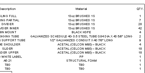

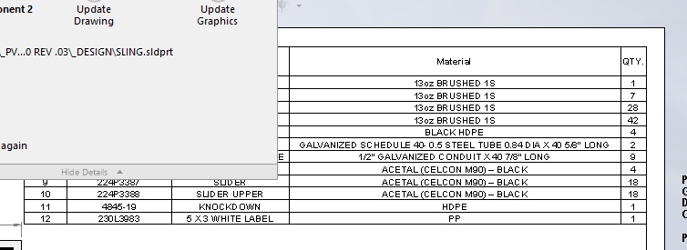

We have this issue lately, when we open up a saved drawing, in BOM and rev tables notes all was saved with the lines but when someone opens it, the lines disappears like in the below picture. even tho you can see the lines when it is loading the drawing. Ones drawing is updated, it's all gone. we can bring it back by clicking the table and change the line thickness from none to min thickness. We want to know what causing this so we can fix the problem for everybody.
this screen shot taken when the drawing was being loaded
this is after loaded.

sorry for the misinformation. Here is what's happening. someone makes a design and drawing and saves it with BOM, note tables, rev tables. Another designer needs to do revision and do a pack and go on that design. Updates the design and when you open the drawing, all the lines in bom, note table and rev block goes to no line. We can deal with it just going and changing it but it is annoying and time consuming process for designers. I have a feeling that it is causing from certain computers and spreading out. I will ask everybody to create a drawing and let everybody open those to see where it is coming from.
all drawings made in SW2019

I don't think it is graphical problem because we can manually bring it back, even when you make a pdf out of it, it doesn't show up the lines in pdf.

The problem is with SP4.0.  Upgrade to SP5.0 and your problem should go away.

We recently upgraded to 2020 SP3.0 and this issue has alleviated itself for us!
RG
RG 2021-04-08
John is correct that this issue has been reported in SPR 11611827. It has been fixed in SW2020 SP2.0. You will need to manually select the table (upper left cross) properties and change the "Border" settings. Otherwise, upgrade to SW2020 SP2.0 to reolve the issue.

It's a know bug
This is, indeed, a known bug in the software (SPR 1161827 – Table border and grid thickness changes to ‘None’ for drawings created/saved in SW2019 SP5.0 and then opened in SW2020). It’s a rather specific description, but it applies to the behavior in general. It’s currently open, so I’ll add your account to the SPR. You’ll be notified of any updates, or if a fix has been implemented in a future version or service pack of SolidWorks. In the meantime, the only real workaround is to manually adjust the setting in the property manager (as you’re currently doing).

It may be an existing feature but in 2020 it turned OFF all of the existing border settings on all of the tables from previous version drawings so there were no borders. You then had to go back and set the borders to the width you wanted rather than those widths carrying into the new version.

Hi Mehmet, I have also come across this issue. Most of our company uses SW 2019 SP03, but we upgraded one user SP05 to test a bug fix. Now, whenever this user creates tables with line thickness of 0.18mm, the lines disappear when opening the drawing in SP03.Are all of your users on the same service pack, or like us are there some on SP05 and some on SP03? This may be the same issue, in which case upgrading everyone to SP05 may fix it for you.
