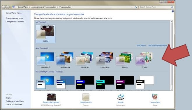

To start using an AERO theme, RMB (Right-Mouse-Button) on your desktop and select PERSONALIZE.
Select a theme out of the row of AERO themes (see picture).  Your computer will pause as it applies the new settings.

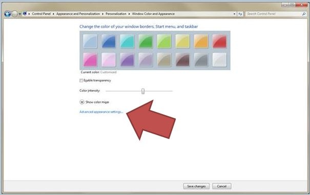

  • Additional window object colors are available thru WINDOW COLOR, then the ADVANCED APPEARANCE SETTINGS link (see picture).

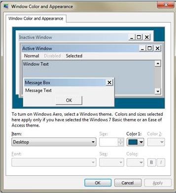

It will take you to the WINDOW COLOR AND APPEARANCE screen where you can set specific colors (see picture).

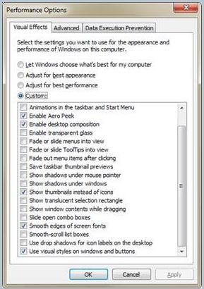

  • DO NOT modify the Advanced System Settings/Performance Options to allow Windows to ADJUST FOR BEST PERFORMANCE or LET WINDOWS CHOOSE WHAT’S BEST.
  • DO NOT turn off USE VISUAL STYLES or ENABLE DESKTOP COMPOSITION.  Any of these modifications will cause the freezing to return.
