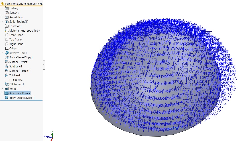

This challenge reminds me on a part I've created back in 2012 when SWX had learned to flatten curved flanges of sheet metal parts. I've also used a fill pattern on the flattened state. But - as you can see - this wasn't a proper solution because of the stretched circles when unflattened.
Edit: I've found some more trials in my archive. Only one has a proper solution. After some research I found, that a golf ball has no regular (equidistant) pattern. And even the diameters are slightly different...

And my solution: SOLIDWORKS (no macros)
Based on the sample I assume "Equidistant"  between points in a row and between rows.
Both Diameter and desired distance can be controlled by "Global Variables".However, the distance is approx. while in both row distance and between the points in the row formulas are calculating closest possible for even distribution.
1. First I made a sketch for both Hemisphere Revolve and calculation purpose
2. Offset Hemisphere top surface
3. Draw a circle and trim surface to have 1 circular surface on the top.
4. Add the first point on the surface centre
5. Equation driven Circular pattern of the surface from the top toward hemisphere edge to form rows
6. Add a point on each surface
7. Add sketch on the top plane to calculate angle which will be used to calculate count of the surfaces in the row
8. Equation driven Circular pattern of the surface in the first row
9. Add points on surface centres
10. Add all from the row in a folder and name it Row1
11. Continue the procedure for all rows
Why rows are in folders: there are formulas that calculate row count and suppress extra rows
Making formulas for the points too was too time-consuming so I left this one out. So after changes in the sizes, some points may need to be suppressed and unsuppressed on other changes.
The model is assumed to be the one with maximum points, if more are needed should be added manually.
When placing point is best to use surface and face filter.
