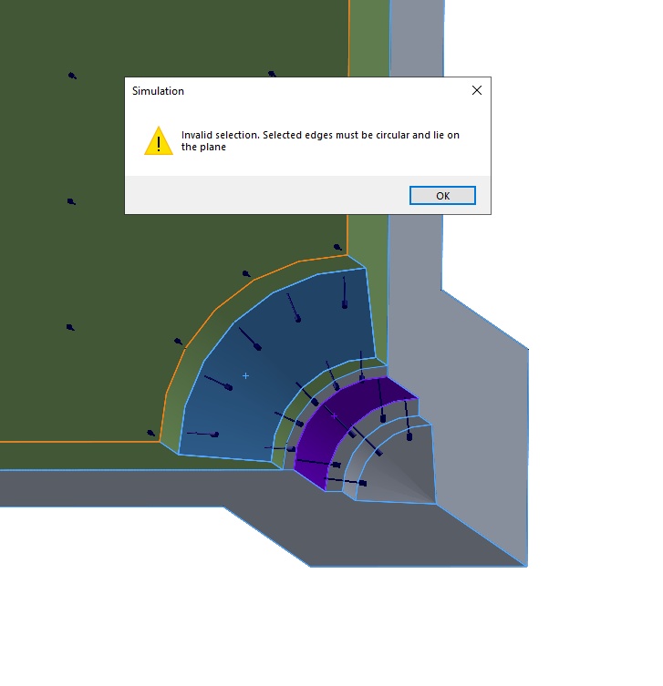

I'm trying to add a 1/4 symmetric bolt (countersunk screw) to one of my models & keep running into an error (see screenshot). What am I doing wrong?
its kind of difficult to see what is going on here, are you trying to add a bolt pattern?
Sorry I should have given a bit more clarity. I have a plate mounted to another plated w/ a (symmetric) countersunk hole pattern. I cut the model into 1/4 & applied a symmetry boundary condition -- this is the resulting center hole (located at the origin).
I am trying to add a fastener feature in Simulate -- and whenever you have a bolt that is cut by 1/2 or 1/4 you have to specify within the feature if it is symmetric. When I go to do that, it gives me this error.
Side note -- when I change the screw type from countersunk to regular hex bolt, it works. So it seems to be an issue with the countersunk + symmetry condition?
It is possible you encountered SPR 1138829 - "Bolt connector giving error message 'Invalid selection. Selected edges must be circular and lie on the plane' when using countersink bolt cut in half by a symmetry plane or when conical face is split." SPR 1138829 is fixed in 2021 SP4.0.
I was able to define a quarter symmetry countersunk screw in version 2021 SP3.0. See the attached model. Consider comparing the definition of this bolt connector with yours.
