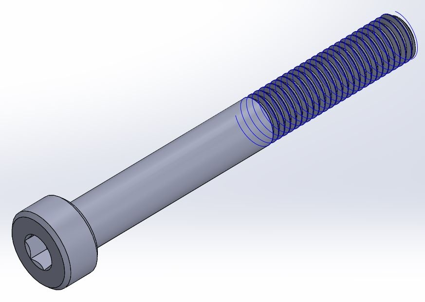

I created a macro that creates a socket head cap screw (see attached)
Everything is working OK, except for the "cutting" sketch for the threads.

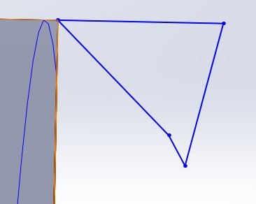

The resulting sketch is attached.
If y is radial distance, and there are only two y values, how does the resulting sketch have 3 radial values??
The end points of the lines are not even located on the calculated x,y values.

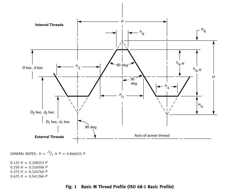

The calculated values are derived from the ANSI attachment.
The sketch looks identical, no matter how many times I run the macro.
Is this sketch error due to the precision of the model? Any other help would be appreciated.
