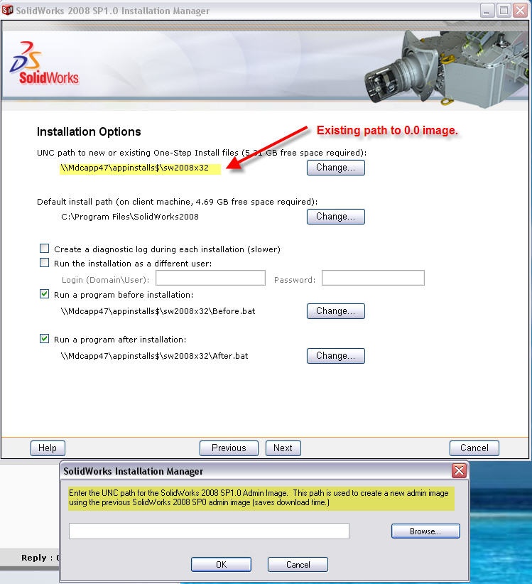

JC
JC 2007-12-06
I have an image setup for 2008 sp0.0 but when I try to applysp1.0 to it through the Install Manager it seems to want to createa copy of the image rather than upgrade the sp0.0 image. It tellsyou to specify the previous image to save download time and specifya new location for the sp1.0 image. What gives?
SF
SF 2008-01-08
You cannot update an admin image the way you used to be ableto do.
Instead you create a new image using the files from the old imageand then delete the old image(if you choose to)
