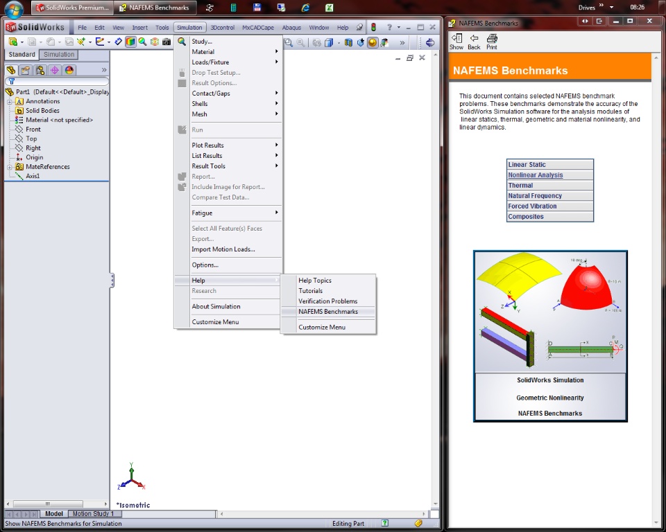

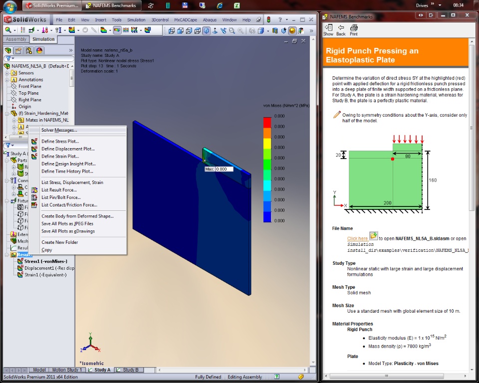

Running the NAFMES benchmarks also yielded unpredictable performance results, with some solutions 10% faster, some solutions 30% slower and others with identical run times.  Solutions using Abaqus showed virtually no difference in performance (typically 1% worse).
