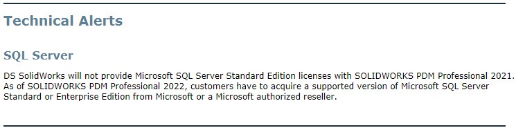

SQL Included with PDM Professional No More
Following the Draftsight decision Dassault has also decided, or has not be able to come to an agreement with Microsoft, to include SQL with PDM Professional licensing. SQL 2014 will be the last version provided and if companies need anything more then the free SQL Express it is going to cost significantly more. There are a few years before we will be forced to upgrade but according to SW's own compatibility chart PDM2022 and SQL 2014 will no longer be compatible. I estimate it will cost my business \\\$20,000 to get the same licenses that are already included and who knows what their yearly maintenance fees are. I have not investigated with the Microsoft CAL licensing complexity yet but it could be a bit less or significantly more. PDM Pro is also included in Dassault's increase in subscription fees. Charged more and receive less that is a nice double whammy! I have talked to two VAR's about this issue and also raised it directly with a SolidWorks sales rep. They were all going to highlight the issue to SolidWorks corporate. Anyone signing 3 year subscription agreements now needs to be aware of this change as it will likely affect you. We need to let SolidWorks know downloading these extra costs onto their customers is not a good way to make people happy. Unhappy customers start to evaluate other options.
PDM2019sp5 Release notes: https://files.solidworks.com/Supportfiles/PDMWorks_Ent_Release_Notes/2019/English/SWPDM_relnotes.htm#relnotes_service_pack_5&_ga=2.54744227.96575954.1574859559-e9e6c7d0-d3c3-11e9-9d15-65efadd5c4a1
Response from Jerome Marget of SOLIDWORKS. (Since this is a discussion I can not mark it answered.)

1-9UT0IM6 wrote:
 I estimate it will cost my business $20,000 to get the same licenses that are already included and who knows what their yearly maintenance fees are.
Yep.
Editions sold in the per-core licensing model are sold as 2 core packs.
So, $7500 or so minimum for the per-core option.

SOLIDWORKS Data Management 2019 SP5 Release Notes
About halfway down the page... "Technical Alerts, SQL Server."

MP
MP 2020-02-21
Peter De Vlieger wrote:
Out of curiosity, having been pondering PDM now for awhile, I've been keeping an eye on this thread. Let's see if I got this straight.
So MS decided a few years ago to jack up the price for the software assurance.
SW decided that they wouldn't pay up and deal with any issues when they had to, believing they could strike a deal when the time came.
The time came and MS had no reason nor enough incentive to give SW a break.
Now the chickens are on their way home to roost.
In a couple of years the old SQL licenses become worthless. Yeah yeah, you can keep using them.... as long as you never intend to get a newer version of SW then 2021 but when you do go for a newer version of SW you can pay extra for the MS SQL license, and yearly fees, as well as the penalty for not having kept up with updating SW yearly. I bet you that there's going to be some serious gnashing of teeth in a whole lot of companies.
Considering the official reaction though it seems that they expect that most will just suck it up and stick with the program (pun intended).
Solidworks own recommendantion is that if you have more then 5 users that use PDM than you should get the PDM Professional which means that not just big or medium sized companies but even some small companies will face the issue.
All in all it makes me glad for having been hesitant to push for PDM implementation because else I would have to explain to my COO and CEO that not only they had invested some serious money in getting the system up and running and maintained but that in less then a couple of years there would be a hefty surcharge on top of it all that the company would have to pay to get MS SQL Server + yearly fees for it as well. If I had pushed for it and had been succesful any fortuneteller could no doubt predict that there was something in my future and it concerned 'slip' and 'pink'.
Good luck to all those that will have to make the annoucement to there boss.
Thank you Grant Mattis for the heads-up.
I too have been watching this thread.  Just out of curiosity, how do you think SW should have handled the situation?  Would a reduction in the cost of PDM Professional maintenance cost make this a more palatable proposition?  Maybe half the cost of the SQL license?  I'm just curious what your thoughts on the matter are...
GM
GM 2020-02-21
Hi Peter,
I believe you are mostly right but my understanding is that when MS Assurance was dropped SW could no longer provide the SQL license to buyers of PDM or Manage. At that point SolidWorks dropped the cost of new PDM licenses to adjust for customers buying SQL. I was never affected by this so I could have some of the details wrong.
I believe PDM Professional can run on SQL Express which is the free version of SQL that PDM Standard runs on. It might be worth looking into exactly what the limitations are or if it is even possible.
When ‌ and I met I very clearly identified that this will be a major issue for PDM Pro customers they will discover when moving to PDM 2022 or beyond. My suggestion was to offer a 1 time discount on the renewal to help makeup for this large extra cost. My quick budget cost based on web information for my company is $20,000. Jerome very clearly told me it would be impossible for SW to absorb 100% of that but he didn't totally rule out some sort of 1 time discount. I hope he is able to sell that to upper management as it will go a long ways to supporting their customers through this issue and resolution.
Our job here is to let SW know what would be an appropriate action to make this right. If you agree with me that a 1 time discount will help then please post. If you have other ideas please post them too.
Let me know if there are any points I can clarify.
Grant
DM
DM 2020-02-21
WELL AIN'T THAT GREAT !!!!  I learn how to implement pdm and now it is going to cost me more?
MP
MP 2020-02-21
How many seats of PDM do you need?  If you don't have that many users, PDM Standard may suit your needs.
DM
DM 2020-02-21
no matter what you do your going to out grow it and I would not feel right presenting something that we could implement and then upgrade to later with an additional 20k for some licence that we just have to have to run pdm?   I can hire a college grad to make me a custom system for less and only have to pay them once the way they like to work.
JS
JS 2020-02-21
They should have switched to an alternate database server.  SQL Server isn't the only game in town.
MP
MP 2020-02-21
Maybe MS Access?
Kidding aside, yeah there are other ones.  But, AFAIK SQL Server is a good one.  I know there are some GPL (maybe even BSD) ones, but I don't know how that'd work (or how good they are in comparison).  SW would probably have to take on support for it, and I'm guessing they don't want to do that...Though, for the money they are charging maybe they should?
This is the typical thing that happens when you don't own the software...Makes me wonder what'd happen if Seimens decided to raise the licensing fee for the the Parasolid kernel...
PV
PV 2020-02-21
Grant,
Matt,
The issue now is indeed what can SW do to make it palatable for new potential customers as well as the existing ones.
Seeing that no matter how you twist it, it ends up being a serious financial burden for customers old and new.
A one off reduction might be nice gesture but I don't see that really sway the opinion of the deciders on the customer side, certainly not those that are new to it all. Softening the blow is one thing but if you look at the financial impact it can and will have towards the customers it will take more, lots more, then giving a one time 25% discount.
Waving the consultancy cost for new customers to get them set up might surely help if it was in combination with discounts but no doubt that would be difficult for the VAR's because they won't be jumping on offering their time for free so unless SW corp is willing to compensate them it's a non-starter.
The same applies for lowering the subscription costs. Nice gesture but unless it's truly signficant and year on year I can't really see that it makes up for it, certainly not if it's a 1 off. Then again it's not very realistic because I can't see SW willing to take the hit year after year.
As far as I can gather, Inventor PDM doesn't include MS SQL Server license either. That's the good news for SW but then the price points of IV PDM compared to SW PDM....hmm....
So unless they are willing to take a major hit and provide a proven far superior product then the competition I can't really see what they can do to prevent people looking into other possibilities, be it downgrading to PDM standard, a 3rd party solution or even, in worse case, different 3D package all together.
In the end it all depends on how many customers they actual have for PDM Pro and how much they are willing to either risk losing those or willing to placate them by doing a combination of price lowering on the package, the subscription and any additonal fees (installation/migration)
Keeping my ear to the ground it sounds to me that they lost a lot of goodwill with the workgroup PDM situation a few years back and this isn't helping them either.
If PDM Professional could run on SQL express without significant loss of functionality then the question rises why doesn't it do that now. Or alternatively why doesn't PDM standard (which does run on SQL Express) have more tools available seeing that workgroup PDM, as I read, was more powerful then PDM standard supporting API and all that. Which seems to have been one reason some went from workgroup PDM to PDM Pro, namely to avoid losing functionality and control.
They are in a pickle. They saw it coming and had years to get to grips with it. Now they have less then 2 years to go. I hope for their sake they figure something out. Something that isn't along the lines of simply rebranding to 3Dexperience PDM Premium Professional (MS Server SQL not included)
JC
JC 2020-02-26
I imagine it could run on SQL express since PDM Standard is just Pro with features turned off. When Standard was created, they made a decision on what to include and not include.
As for SQL express......you're limited to 1gb of memory for the database, 10gb database size, and 4 CPU cores. Also the SQL agent is not included so you can't run automated tasks such as backups and indexing. None of that would fly for our installation (500+ users)......and I'm not sure I'd recommend it for a small operation either. No backups is a no go IMO.
Looks like Vault Pro pricing is $665 for a single locked user license. I see reference to $1330 for 1 floating user license. There are annual subscriptions. PDM Pro was $1895 upfront plus $495 annual, all floating. Wonder if that's been reduced with SQL removed? we have a 100 user PSL and 100 Viewer licenses (20, 5 user packs) so I don't know where that leaves us on what we need.......time to contact the VAR I suppose.
JM
JM 2020-02-27
Thanks to all of you for your inputs on this forum.
A couple of you are trying to understand what would be the cost attached to a SQL Server upgrade.
To start with, here is what has been available on our price list:
#1.PDM standalone license without SQL Server license: Yes, it has always been an option for our customers to purchase PDM licenses ONLY with NO SQL License.
#2.PDM standalone license with SQL Server license: In this scenario runtime restricted SQL Server Standard Server+CAL licenses were provided together with the PDM seats.
#3.PDM Universal licenses (PSL 25,50,100,200) with SQL Server license: In this scenario SQL Server Standard Core Based Licenses were provided (4 Cores: 2 packs of 2 Cores).
If you picked the first option (No SQL), then the change we recently made does not affect you at all since you sourced SQL Server licenses yourselves.
If you picked option number 2 or 3 then you are entitled to use SQL Server Standard 2014.Should you need to move to SQL Server 2019, you would need to source the following:
Option Number  2: A license for the server and X client CAL Licenses (where X is the number of users or devices that need to be licensed. Please work with your reseller to find out what your X is and make sure you comply with MS SQL Server Licenses policy). Prices with Microsoft may depend on geo but a Device/User CAL license can be purchased for less than $180 (USD).
Option Number  3: Here you do not need to care about the number of users or devices that will access the PDM vault. You only need to care about the SQL Server hardware (See Microsoft SQL Server licenses policy to make sure you purchase enough Core licenses). As stated above, we used to provide 4 Cores. Prices with Microsoft may depend on geo but a pack of 2 Core license can be purchased for less than $3,000 (USD). So that would be $6,000 for 4 cores. As a comparison with Option Number 2 (Server + CAL model),  if you own a UL-50 (ex PSL-50) for instance with 75 users that can access the PDM vault, the cost per user would be less than $80 (USD).
, the $20,000 you mentioned sounds huge to me. The only reason I can think of is that you might have a quote using SQL Server Enterprise (DS SolidWorks has never offered Enterprise. Only Standard). If not then that probably means those numbers are based on the Server + CAL model. In that scenario, I assume it is time to look into the Core Based model which may be cheaper based on the number of Users/devices to license. But in any case, let’s take that offline and feel free to contact me directly with an email so that we can review the various options you have.
I hope that helps.
Jerome
JM
JM 2020-02-27
Hi ‌,
I confirm that the cost for new Universal Licenses (ex PSL) has been lowered since we won't provide any SQL Server licenses anymore moving forward (Pricing varies on Geo so please work with your reseller for further details).
In your situation, It is likely that you are entitled to 4 Cores license of SQL Server (To Be Confirmed by your VAR since it depends on what has been ordered with us exactly). So should you want to upgrade to a newer version of SQL Server, please refer to my previous post where I mentioned "OPTION NUMBER 3" that is probably your case.
I hope that helps.
Jerome.
