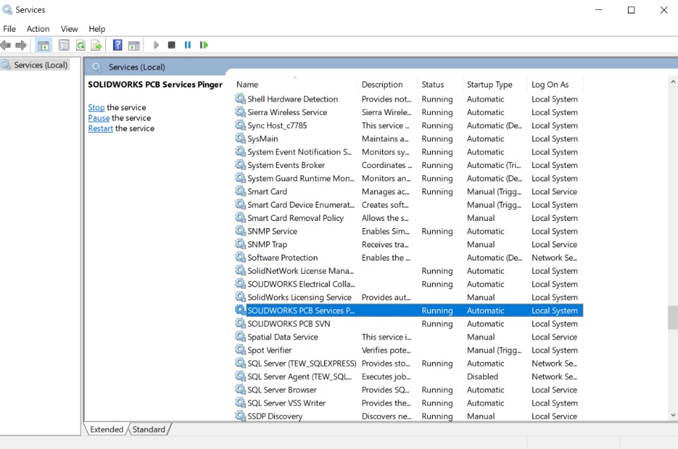

Therefore I can't create any new project. In the Windows Services it seems that the PCB services are running:
I tried restarting them from here, but it didn't help. I also tried reinstalling PCB Services, but that didn't help either.

No, sir. I tried disabling everything, to no avail. But I did manage to fix the issue by doing a complete PCB Services reinstall with some more reinstalls as well. Here is the instruction I followed that worked for me:
  1. Open a Windows PowerShell by using the "Run as administrator" option.
  2. Run the following commands:
    net stop WAS /y
    rmdir /s /q C:\inetpub\temp\appPools
    net start W3SVC
  3. Completely uninstall all SOLIDWORKS PCB services from Control panel.
  4. Make sure that the SW PCB Services data folder is empty (Default path: 'C:\ProgramData\SOLIDWORKS\SOLIDWORKS PCB Services\'). If not, delete this folder manually.
  5. Make sure that the program folder is empty (Default path: 'C:\Program Files\SOLIDWORKS Corp\SOLIDWORKS PCB Services\'). If not, delete this folder manually.
  6. Uninstall 'Firebird' (Control Panel > Programs > Programs and Features > Firebird).
  7. Uninstall 'MSI to redistribute MS VS2010 CRT libraries'
  8. If you do not have any used sites on the IIS, please reset IIS to default settings:
    - From the Start menu, open the ‘Turn Windows features on or off’ feature.
    - In the Windows Features dialog box, disable 'Internet Information Services' and 'Windows Process Activation Service' features and restart system (these features will be activated during the SW PCB Services installation).
  9. Perform clean installation of SOLIDWORKS PCB Services through Installation Manager.
    - Disable all firewalls and antivirus systems (important step).
    - Download the latest service pack from the Customer Portal and run Setup SW IM as an Administrator.
    NOTE: perform all Uninstall/Install procedures under local Windows Administrator user account.
Thank you anyway!
