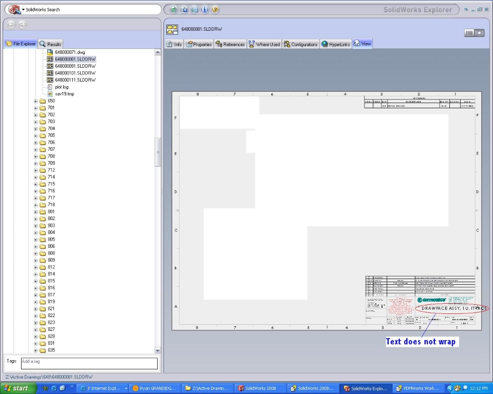

When using SolidWorks Explorer, if I click on View, the e-drawingsfile does not wrap the text in the title block. Does anyone knowhow to fix this (do I have to format my drawing differently)?
I did save the file as an e-drawing to check if that was theproblem, but it wraps the text. So I'm not sure why it would notwrap the text in the SW Explorer view.
The reason I need this to work is because I have an admin whoupdates the properties (checker and approver) and then prints thedrawings to PDF.
Thanks
