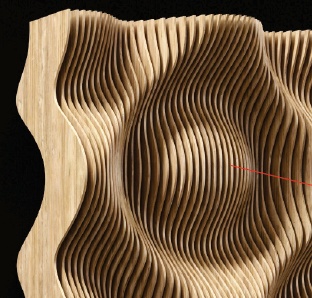

Hi,
I would like to ask how to design a certain part with bumps and curves.
If anyone has an idea how to model please let me know.
Any help will be greatly appreciated.
Thanks,
Jose A.

This part seem like a pretty straight forward design using sin and cosine wave... maybe try equation driven curve and a boundary/loft surface with thicken?
https://www.cati.com/blog/2017/01/magic-of-solidworks-equation-driven-curves/
and then
https://www.engineersrule.com/the-solidworks-boundary-surface-feature/
