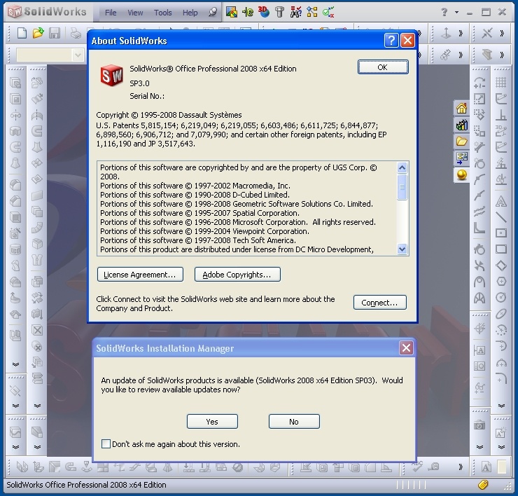

FYI,
I often get this warning. I use the old school way of updating(manually downloading each update and installing)...

SF 2008-02-28
Michael Wilson,
I also get that "an update is available" whenever I openSolidworks, and it tells me 2.1 SP is there, when I am already onSP2.1. I am wondering if it is because I used the "if you're havingproblems" button to update, and download a much smaller file,instead of going thru the official "installation manager" method? Idownloaded almost 4 gigs of files to update to SP2.0 and it nevergave me that message. After I used the shortcut it has beennotifying me. I just told it never to notify me again for thatupdate. Which made it stop, in my opinion, something else in thepantheon of needed improvements to the SP process.
